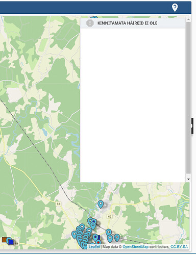

Hi,
**Ignition v.8.1.17**
My Docked window can’t be hidden
Is this a bug?
 ![image](https://us1.discourse-cdn.com/inductiveautomation/original/3X/f/7/f737bb48345bf0f57fe12bfd5e38fad20bc8184d.jpeg)
Actually, it opens autmatically… so… as You can see, there’s a button, which opens this docked window…
…and when I push on it, the screen looks like (Docked window goes on docked window…):
 ![image](https://us1.discourse-cdn.com/inductiveautomation/original/3X/5/4/5452f04b8c61ec754e5ccc6ee60fdfe6e1d083b3.jpeg)
Docked Window Properties:
 ![image](https://us1.discourse-cdn.com/inductiveautomation/original/3X/d/0/d0810ecdb36839585ce10de40c98e69bf851aead.png)
I will be grateful if somebody can help me.
Thanx in Advance!

Do you maybe have that same view embedded in whatever it is we see in the background ?

Nope…
I just Upgrated the Ignition from 8.1.9 to 8.1.17 and I get this issue…
The normal view of this page is (The Docked View is hidden):
 ![image](https://us1.discourse-cdn.com/inductiveautomation/original/3X/9/a/9adccea5c92455d57db27b6679d74e77ddda7100.jpeg)

I found the bug) I did some weird stuff during creation of this page, so some artifacts are still there)

ViewCanvas element was pasted on the page, but the basis of this Canvas was set to ‘0px’, but somehow it was shown on the page no matter what) on the older version of Ignition this element is hidden, but not in the new one… so…

A basis of 0px is not going to make it invisible. Any content within is still going to overflow the boundaries. The only way to stop content from being visible outside of the bounds is to toggle the `meta.visible` or `meta.display` props (depending on container type) or to manage the `style.overflow` property.

Thanx for Your answer! Get it! 🤝
