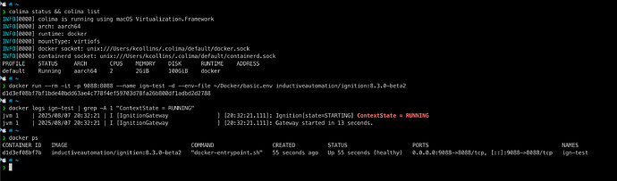

Thank you for providing this. It looks like you’re using [colima](https://github.com/abiosoft/colima) for Docker on macOS. Admittedly, I hadn’t used colima before but I took it for a quick spin on my M2 Max MBP here and everything seems to work as expected, with the gateway starting up in ~12 seconds.
Just one more piece of information gathering if you wouldn’t mind:
```bash
colima status && colima list
Even with the fairly minimal defaults of 2 vCPUs and 2GiB of RAM, a single gateway container seems to launch alright. I captured a brief snippet of my testing with Colima, fwiw:
 ![SCR-20250807-ntht](https://us1.discourse-cdn.com/inductiveautomation/original/3X/2/d/2d711bee67ea9fb25ee20beb49f97131a7e91adb.png)
You’d definitely need to adjust those defaults if you’re running multiple containers to avoid slowdowns.

Oh man 🤦. It didn’t even occur to me that colima itself might be the bottleneck. I’m running a small k8s cluster on the same machine too.
Increased to 4cpu and 8gb memory, and the gateway started instantly with no issues.
I should have realized when the docker commands were taking so long. Thanks a lot!
