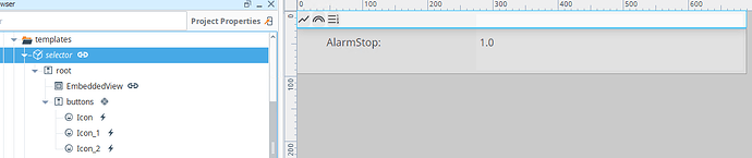

Hi!
I'm working with a flex container but for some reason I'm not able to make it work with the components inside.
Does the z-order not work on flex containers?
Here my problem:
 ![{B5EE0B44-ACC2-44E5-9BC0-2C935B088F1E}](https://us1.discourse-cdn.com/inductiveautomation/original/3X/d/7/d7ea771f72b98abf45605e37d77040d5e102f260.png)
 ![{4E3C53C0-A794-4A93-B596-42D82C21BF6C}](https://us1.discourse-cdn.com/inductiveautomation/original/3X/1/c/1cd696b12a6dcd2a4e0e96fcb1e6364aeee3cb04.png)
The margin of The EmbeddedView is set to -25px so the buttons overlap. Even that buttons are on the "front" they don't show. No idea why.
Thanks!

**Author:** ![danielps1818](https://avatars.discourse-cdn.com/v4/letter/d/ecae2f/32.png) [@danielps1818](https://forum.inductiveautomation.com/u/danielps1818)\
**Post date:** [December 11, 2025, 3:41pm UTC](https://forum.inductiveautomation.com/t/does-z-order-in-perspective-work-with-flex-containers/112760/3 "2025-12-11T15:41:49Z")
Well apart of that...
I had set a background color in the embedded view (funny)
Thx for the help!
