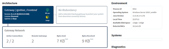

What version of Ignition is this? There's been some recent changes to try to hold authentication state better in the Designer and Vision.
**Author:** ![Michal\_Goralczyk](https://sea1.discourse-cdn.com/inductiveautomation/user_avatar/forum.inductiveautomation.com/michal_goralczyk/32/55564_2.png) [@Michal\_Goralczyk](https://forum.inductiveautomation.com/u/Michal_Goralczyk)\
**Post date:** [April 20, 2023, 8:58pm UTC](https://forum.inductiveautomation.com/t/domain-login-to-designer-problem-returning-after-connection-lost/72699/4 "2023-04-20T20:58:06Z")
My version below:
 ![image](https://us1.discourse-cdn.com/inductiveautomation/original/3X/3/f/3f523d4ea8450b11d28177f9651455b51fb000eb.png)
