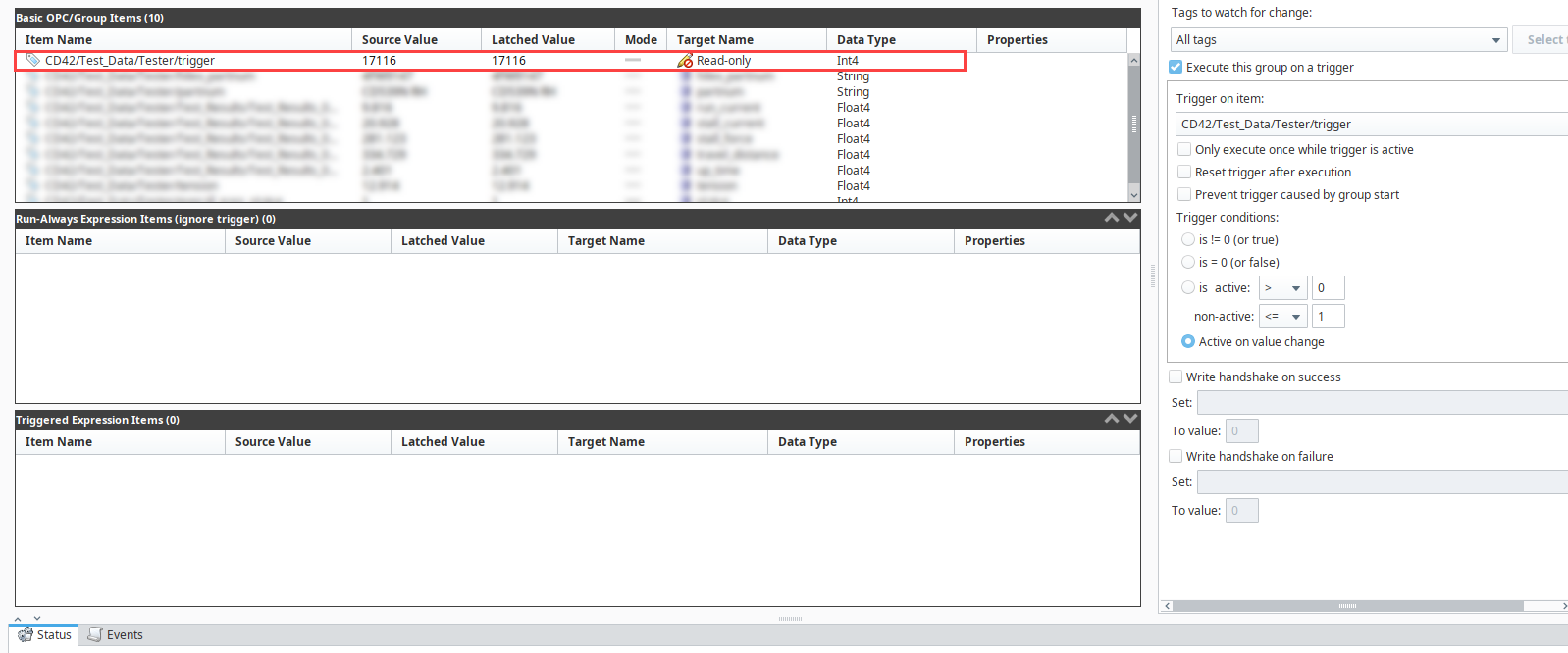

Hi guys,
In our AB PLC, I have setup a counter to increment every time a particular event happens. In an Ignition project, I have setup a historical transaction group to log the counter on change as well as the serial number of the part at that time.
As you can see, data is being logged even though the counter is not changing… Any ideas?
 ![image](https://us1.discourse-cdn.com/inductiveautomation/original/2X/f/fa478867d77c9f578c27fea07ce9bec49a05e799.png)
Dion
**Post date:** [January 21, 2019, 5:24pm UTC](https://forum.inductiveautomation.com/t/double-data-logging/22021/2 "2019-01-21T17:24:08Z")
Looks like you’ve accidentally selected the serial number to monitor for changes.

Since a trigger is not being used, it will log an entry whenever either of your values change.

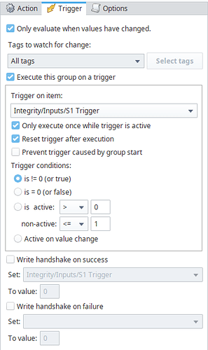

**Post date:** [November 12, 2019, 7:50pm UTC](https://forum.inductiveautomation.com/t/double-data-logging/22021/5 "2019-11-12T19:50:04Z")
I never found a solution to my problem and so found a work around (not using transaction groups). A colleague of mine is using transaction groups for another project and is seeing the same thing…
He has his PLC go through a sequence and on completion sets a boolean tag which triggers the transaction group to log a bunch of data about the sequence. Here are the trigger settings:
 ![image](https://us1.discourse-cdn.com/inductiveautomation/original/2X/2/2ab8d63c775f969a0e38ef25920e707a74510361.png)
Interestingly, when we use a simple memory tag to trigger the transaction group it only logs 1 row of data as expected…
**Post date:** [November 12, 2019, 9:58pm UTC](https://forum.inductiveautomation.com/t/double-data-logging/22021/6 "2019-11-12T21:58:31Z")
Consider using an integer for the trigger. Increment it once per cycle. Go as high as you feel comfortable for the value, then roll it back to zero.

**Author:** ![ccontreras](https://sea1.discourse-cdn.com/inductiveautomation/user_avatar/forum.inductiveautomation.com/ccontreras/32/40931_2.png) [@ccontreras](https://forum.inductiveautomation.com/u/ccontreras)\
**Post date:** [November 19, 2019, 10:27pm UTC](https://forum.inductiveautomation.com/t/double-data-logging/22021/7 "2019-11-19T22:27:33Z")
Can you verify that you do not have a copy of this transaction group somewhere else on your gateway writing to this same database table? Generally, when I see double logging like this, there is another transaction group either on the same project or on another project pointing to the same table. Can you confirm that this is not the case?
**Author:** ![dion.botha](https://avatars.discourse-cdn.com/v4/letter/d/46a35a/32.png) [@dion.botha](https://forum.inductiveautomation.com/u/dion.botha)\
**Post date:** [November 20, 2019, 3:17pm UTC](https://forum.inductiveautomation.com/t/double-data-logging/22021/8 "2019-11-20T15:17:06Z")
Ahhhh, my colleague had 2 other previous version projects that may have been causing this. His understanding was that Transaction Groups only run in the client space which I looked up to be false. He already found a work around for this and deleted the other projects so I can’t verify this was the case but thank you very much, very reassuring to know we have a probable cause so that we can use Transaction Groups in the future.
