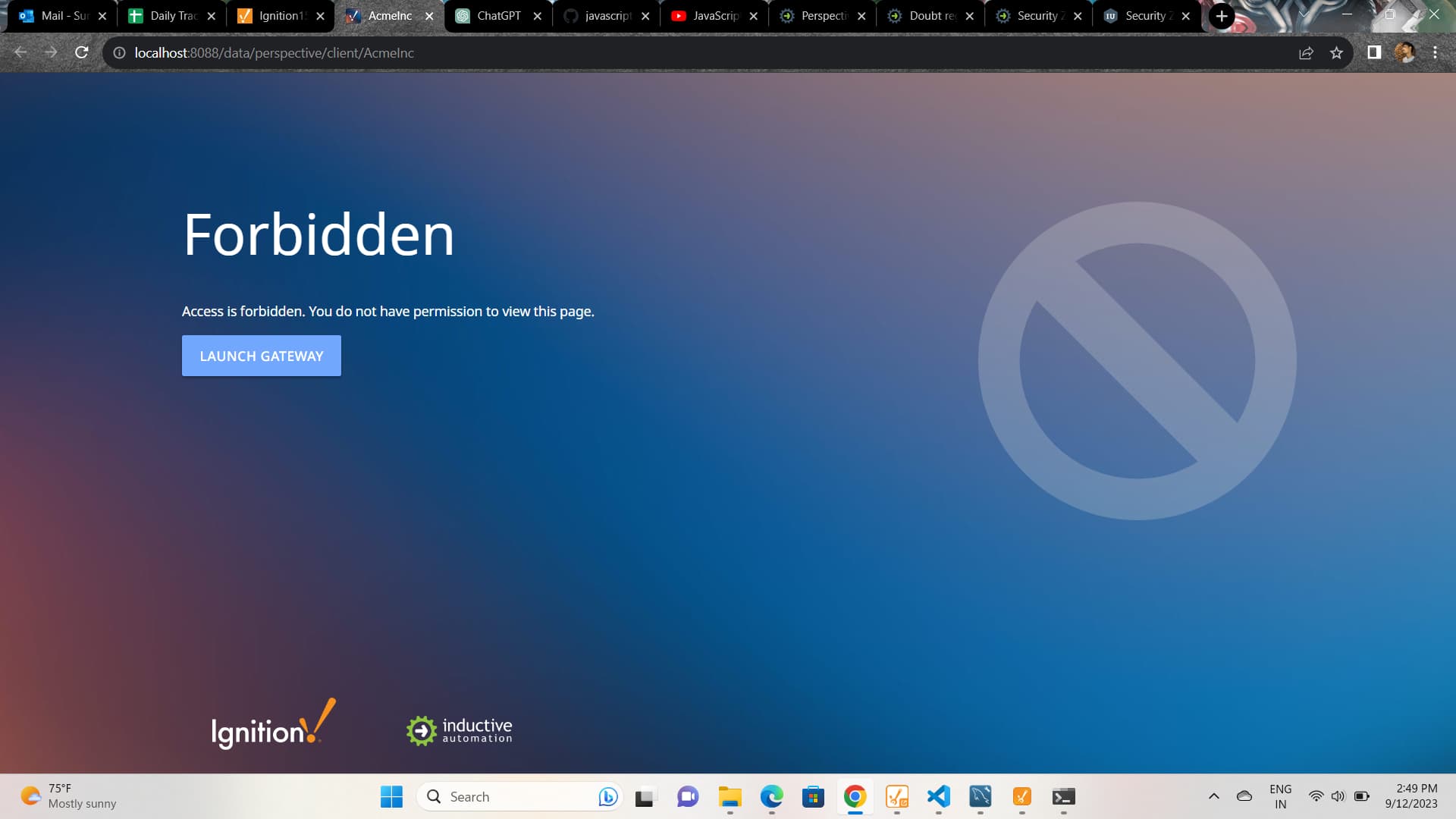

**Author:** ![Surya\_Chandra\_Mohan](https://avatars.discourse-cdn.com/v4/letter/s/a9adbd/32.png) [@Surya\_Chandra\_Mohan](https://forum.inductiveautomation.com/u/Surya_Chandra_Mohan)\
**Post date:** [September 12, 2023, 9:22am UTC](https://forum.inductiveautomation.com/t/doubt-regarding-perspective-security/78997/3 "2023-09-12T09:22:06Z")
Hello,
I created a security zone and then selected the same zone in the permission section under project properties in the designer. I even enabled the realtime provider seetings on the gateway but my perspective project is not launching
 ![Screenshot 2023-09-12 144957](https://us1.discourse-cdn.com/inductiveautomation/original/3X/c/2/c2c6b6b085390a49e5473678ce164887adb9cd72.jpeg)
Can you please help me out with this issue
**Author:** ![Hayden\_Watson](https://sea1.discourse-cdn.com/inductiveautomation/user_avatar/forum.inductiveautomation.com/hayden_watson/32/48792_2.png) [@Hayden\_Watson](https://forum.inductiveautomation.com/u/Hayden_Watson)\
**Post date:** [September 12, 2023, 9:23am UTC](https://forum.inductiveautomation.com/t/doubt-regarding-perspective-security/78997/4 "2023-09-12T09:23:27Z")
That will be because your machine is not in the Security Zone you configured, I'd check your security zone configuration to make sure your machine has access.
You can also list out different zones in the configs, I tend to create a super developer role and allow access everywhere for that role so I can go around all my zoning when testing
**Post date:** [September 12, 2023, 9:50am UTC](https://forum.inductiveautomation.com/t/doubt-regarding-perspective-security/78997/5 "2023-09-12T09:50:05Z")
Hello,
How to know to which zone, the particular users are assigned to or how to add particular users to a security zone?
**Post date:** [September 12, 2023, 12:29pm UTC](https://forum.inductiveautomation.com/t/doubt-regarding-perspective-security/78997/6 "2023-09-12T12:29:25Z")
If you configure them, you can set the IP range or hostnames. Or if a gateway the gateway names.
If you have made a zone where your IP/hostname isn't in that range you can't access it
