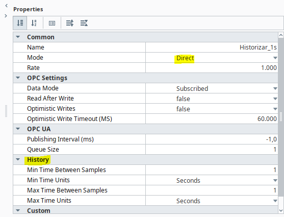

1. If a **Tag Group** (Scan Class) is configured to historize tags with **Direct** mode, then the **History options** are ignored? I understand that the tags will be recorded at the indicated **rate** , regardless of the Min Time and Max Time.
![image](https://us1.discourse-cdn.com/inductiveautomation/original/3X/f/5/f53a2d0c38624964d1f80e44fc707d48246d6f57.png)
Not exactly. When driving tag history, the scan class indicates how often the system should decide to store a point - but a rate of 1 second (or 10 seconds, or anything else) does not, by itself, mean that a data point will actually be stored into the database every 1, 10, etc seconds.
[https://docs.inductiveautomation.com/display/DOC81/Configuring+Tag+History#ConfiguringTagHistory-MaxandMinTimeBetweenSamples](https://docs.inductiveautomation.com/display/DOC81/Configuring+Tag+History#ConfiguringTagHistory-MaxandMinTimeBetweenSamples)
That manual page goes into more detail. The short version is you can override the sliding window algorithm behavior to force an actual row to be logged by using the min/max time settings.
