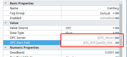

I have Ignition version 8.0.7. I have tried to drag and drop tags from OPC browser to Ignition tag browser which is on a remote provider (gateway 7.9.12). It doesnt work. This is a scaled out architecture where you have a front end gateway (that hosts screens) and a backend server that hosts the tags. Please advise how to overcome this issue.
**Post date:** [April 21, 2020, 8:00pm UTC](https://forum.inductiveautomation.com/t/drag-and-drop-tags-from-opc-browser-to-remote-tag-provider-does-not-work/34090/2 "2020-04-21T20:00:07Z")
The OPC items need to be in the same gateway as the origin of the remote tag provider. You probably need to open a designer pointed at that gateway to use drag-and-drop.

@pturmel I alreday have the remote provider (version 7.9) to be the default tag provider in my project designer (version 8). I am wondering if this issue is due to version incompatibility. i cant even edit tags or view UDT definitions. Its a read only mode let alone drag and drop from OPC browser.

You can try it this way, create a OPC Tag, use its ‘Edit…’ function instad of 'Browse OPC’and bind to the corresponding OPC tag to see if it can have an effect
