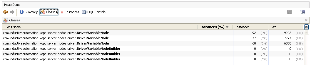

I just analyzed a few heap dumps. Does ‘StaleCheckList’ ring any bell?
After the driver restart, the number of driver variable nodes increased, and i have a lot of nodes that are only referenced by this staleCheckList.
When i restart the OPC-UA module there are suddenly two different DriverVariableNode classes in the heap dump. One of them (seems to be stale) has only nodes referenced by staleCheckList. After every OPC-UA restart another stale class is added.
 ![](https://us1.discourse-cdn.com/inductiveautomation/original/2X/d/d12b74c5d94a7aea12f1e0491028ec0615bdecdb.png)
After seeing this, i did a test with the Simulation driver, and it shows the same behaviour:
`INFO | jvm 1 | 2013/04/01 20:56:56 | DEBUG [DriverVariableNode] [20:56:56,646]: Setting [Sim]_Meta:Random/RandomInteger1@1000ms to stale. Last update was 8162ms ago. Max age is 5000.0ms.
I think the key to this that i call #setValue on nodes, even if there are no subscription (I think that is the same way the \_Meta tags in the Sim Driver work). My guess is, that those nodes are added to a stale checker and never removed from it. As soon as there has been a subscription, the stale checker starts throwing those warnings.

[quote=“chi”]I just analyzed a few heap dumps. Does ‘StaleCheckList’ ring any bell?
[attachment=0]HeapDump.png[/attachment]
I think the key to this that i call #setValue on nodes, even if there are no subscription (I think that is the same way the \_Meta tags in the Sim Driver work). My guess is, that those nodes are added to a stale checker and never removed from it. As soon as there has been a subscription, the stale checker starts throwing those warnings.[/quote]
I think you’re on to something, I’ll look at the stale checker’s removal logic.
I can’t get the same behavior to happen with the Sim driver though… what version are you using again?

Ok, I’ve attached a 1.5.7-beta1 OPC-UA module.
Please verify that upon restarting both your driver module and the UA module itself the instance count of DriverVariableNodes remains the same in the profiler (assuming the rest of the system is in a static state).
I have verified that this is the case with the UA module + AB driver module.
I’ve also found the lingering reference that was causing StaleCheckList instances to persist across module restarts (and along with that reference came instances of practically everything else, not just StaleCheckList… 😊) and fixed that as well.

I did some tests with the new module, here are the results:
The instance count of DriverVariableNodes remains the same. I get a lot of info messages from ‘StaleCheckList…marked for removal’ now after the restart.
The ‘Setting … to stale’ messages are now gone, so this problem should be fixed.
After a restart of the OPC-UA module, there are now no old instances of DriverVariableNode anymore (though the classes are still not unloaded).
Only noticable thing is that there are still no MonitoredItems readded after a driver restart.

Good job, beta2 looks good to me.
Count of DriverVariableNodes remains the same after restarts, MonitoredItems are now added after a driver restart.
I don’t see any unusual messages any more.
The time delay after OPC-UA module restart mentioned in my last post may be caused by the client, not by the server. The subscription are added as soon as the clients connection to the old instance times out.
Last minor issue is that there remain active instances of XOPCModule and XOPCServer (that keep references to all drivers, services…) after a restart. They are however deleted after ~5-10 minutes (after someting times out internally?).

So it actually turns out that BundleUtil leaks the ClassLoaders of:
a) any module that adds a bundle and doesn’t remove it.
b) any module that adds a PersistentRecord (the properties file associated with the record is automatically loaded when given to SchemaUpdater#updatePersistentRecords() but never unloaded).
So… that should be fixed for 7.5.7.
