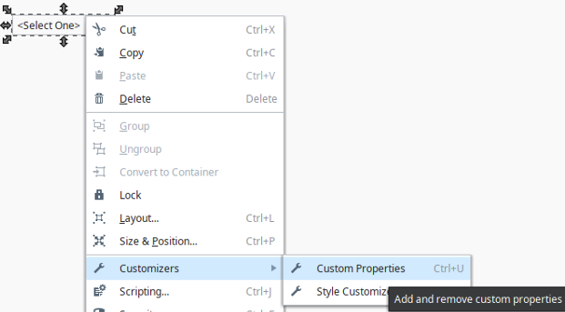

First, add a custom property to the second dropdown called `masterDataset`
 ![image](https://us1.discourse-cdn.com/inductiveautomation/original/3X/6/f/6fbfac713c572f437be729bf878adda48ac80191.png)
![image](https://us1.discourse-cdn.com/inductiveautomation/original/3X/7/4/746ce5ec0b799d13f1e22839c58cade8eab195eb.png)

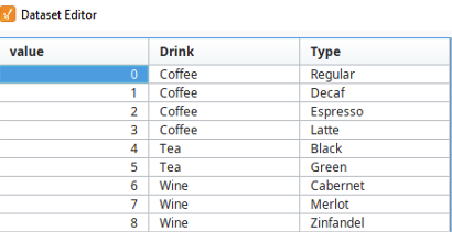

Add columns for value, and every other category
 ![image](https://us1.discourse-cdn.com/inductiveautomation/original/3X/f/0/f0130d14f61b1fd124674143fb242e56b365c548.png)
Populate it with all of the data.
When completed, it should look like this:
 ![image](https://us1.discourse-cdn.com/inductiveautomation/original/3X/b/0/b08c85d19a968fc4c52c791c46294357c6f90943.png)

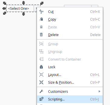

Finally, right click on the first dropdown, and select scripting:
 ![image](https://us1.discourse-cdn.com/inductiveautomation/original/3X/a/7/a7356051ddce124bd12b51110e16ce228eb9ee71.png)

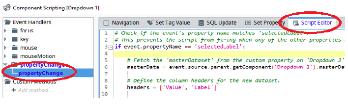

Put a script into the propertyChange event handler that loops through and pulls out the data you want based upon the selection in the first dropdown:
 ![image](https://us1.discourse-cdn.com/inductiveautomation/original/3X/0/4/0412515326378e801018e98f7812a69a15197bda.png)
```auto
# Check if the event's property name matches 'selectedLabel'.
# This prevents the script from firing when any of the other properties change
if event.propertyName == 'selectedLabel':
	# Fetch the 'masterDataset' from the custom property on 'Dropdown 2'
	masterData = event.source.parent.getComponent('Dropdown 2').masterDataset
	# Define the column headers for the new dataset.
	headers = ['Value', 'Label']
	# Create a sublist by looping through each row of the masterData.
	# For each row, we fetch 'value' and 'Type' columns. Only include rows where the 'Drink' column matches the new value of the event.
	sublist = [[masterData.getValueAt(row, 'value'), masterData.getValueAt(row, 'Type')]
				for row in range(masterData.rowCount)
				if masterData.getValueAt(row, 'Drink') == event.newValue]
	# Convert the created sublist into a dataset with the previously defined headers.
	subData = system.dataset.toDataSet(headers, sublist)
	# Update the 'data' property of the 'Dropdown 2' component with the newly created dataset.
	event.source.parent.getComponent('Dropdown 2').data = subData
