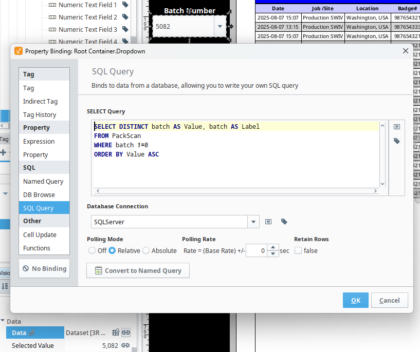

I have used the following SQL Query Binding in many DropDown List Components (In Vision) to populate the DropDown List (Data) for user selection. The project I am currently working on is Ignition Version 8.1.48
 ![DropDown Data Binding that does not work in ver8_1_48](https://us1.discourse-cdn.com/inductiveautomation/original/3X/4/0/40ddc4ed9b0f56eb6b96fe918ccd1121ac95c8ba.png)
I get the following error msg when using it now.
 ![Dropdown Vision Query Binding ErrorMSG](https://us1.discourse-cdn.com/inductiveautomation/original/3X/8/4/84b77139a12ffe1260dc3f36b211cf146498ffb7.png)
I am curious why this worked in older versions and now does not seem to function. Or what did I miss that would make this binding function?

Whatever table you are selecting from doesn’t have a column called `No Selection`. If you are trying to just have ‘No Selection’ as text in the second column, wrap it in single quotes `’ ’`. Double quotes `” “` in SQL denote identifiers, such as table or column names.

I tried the single quotes → ‘No Selection’ and then received the following error msg.
 ![Dropdown Vision Query Binding ErrorMSG2](https://us1.discourse-cdn.com/inductiveautomation/original/3X/b/9/b952b32411788686b6fd76d903002f4f8a3c01de.png)
This isn’t currently affecting the project I am working on it is just an annoyance since it has worked for me so many times before. I did realize that I am now working with SQL Server and all me previous projects were in MySQL. Could that be the difference?

In MSSQL, UNIONs require the columns in the same positions to be similar types. Try casting batch to a NVARCHAR in the ‘Label’ column
try
`SELECT batch as Value, CAST(batch as nvarchar) as Label`
instead of
`SELECT batch as Value, batch as Label`

This makes sense now. After changing the double quote “No Selection” to single quotes, ‘No Selection’ I jumped to the conclusion that the error was still flagging the ‘No Selection’ part of the query. I tried Cast(batch as nvarchar) AS Label and received the same error msg, converting varchar to bigint. Here is another wrinkle in my first question. The SQL Query that is installed and currently functioning is the following →
 ![Dropdown Data Binding query](https://us1.discourse-cdn.com/inductiveautomation/original/3X/4/5/45237e24ea8b3d77f167ad5912f2a694b6733054.png)
Why does this one convert the bigint to varchar and as soon as I try to display some defaults like the UNION with the ‘%"‘ and ‘No Selection’ throw an error?

Technically in the simpler SQL, the SQL is NOT converting anything to nvarchar. The data is being provided back as BIGINT, and java(Ignition) uses it as such. There might be some java stringify happening to make the selected label value in the dropdown a string, but that’s all on Ignition side.
Regarding the Union, I just realized you need to cast BOTH columns as NVARCHAR. `%` is not a valid integer value. So you would need: `SELECT CAST(batch as nvarchar) as Value, CAST(batch as nvarchar) as Label`
I’m guessing MySQL would look at the union columns and determines which type worked for both columns, hence no explicit casting.
