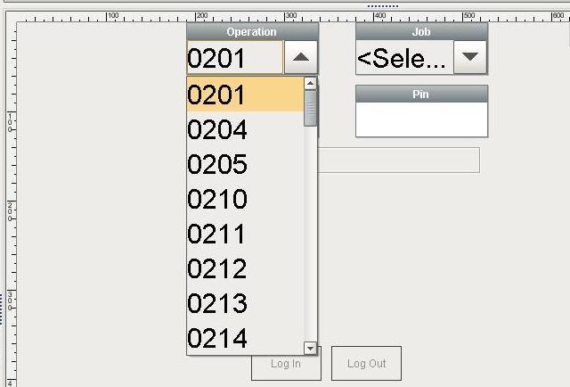

Users on touch screens would like the slider to increase in size.
Font is set at 30.
Ignition 7.4.1
 ![](https://us1.discourse-cdn.com/inductiveautomation/original/2X/f/f4014f32754a25d48b9cdc47d12d1cb28032b297.jpg)
**Author:** ![Travis.Cox](https://avatars.discourse-cdn.com/v4/letter/t/b9bd4f/32.png) [@Travis.Cox](https://forum.inductiveautomation.com/u/Travis.Cox)\
**Post date:** [April 13, 2012, 3:08pm UTC](https://forum.inductiveautomation.com/t/dropdown-slider-size/4288/2 "2012-04-13T15:08:12Z")
Check this [post here](http://inductiveautomation.com/forum/viewtopic.php?f=70&t=5633&p=14535#p14535). It shows how to put a simple script in startup to make the scrollbars larger.
