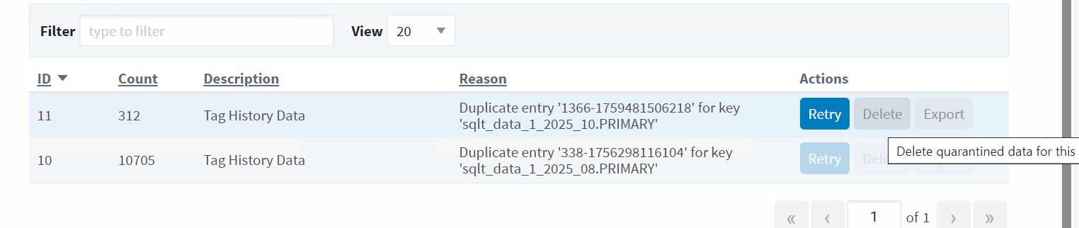

hi, I have an issue with Ignition store and foward entry that remain in quarantaine and the reason is Duplicate entry
is anyone know how to solve that issue?

**Post date:** [October 3, 2025, 2:50pm UTC](https://forum.inductiveautomation.com/t/duplicate-entries-in-database-issue/111174/2 "2025-10-03T14:50:24Z")
This is common when there is a lot of tag configuration happening, and/or database connection issues happening. To ensure history isn't lost, any unconfirmed inserts may be repeated and typically clash with the database's primary key constraints.
You should use the retry button to ensure that all have been processed. Any entries that come back up after that can be deleted.

I already use the retry button and they are all comming back, can you share me how to delete the entry that come back up

is it from this page that I delete it:
 ![image](https://us1.discourse-cdn.com/inductiveautomation/original/3X/c/5/c57fa978ea9bacd2afbe218aced3486cfc01ff7a.png)
**Post date:** [October 3, 2025, 4:07pm UTC](https://forum.inductiveautomation.com/t/duplicate-entries-in-database-issue/111174/5 "2025-10-03T16:07:40Z")
Yes, right there.
