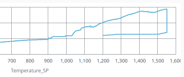

Hello,
I have a XYChart in Perspective, X axis data is temperature of the kiln, it have a rise stage and drop stage, so the temperature data on X axis are duplicated, and it causes the curve to display to the left (it should display to the right like a mountain peak), below is the screenshot, how to fix this problem?
 ![图像](https://us1.discourse-cdn.com/inductiveautomation/original/3X/6/0/60e53514c8e47c6e7790e4c8ed7f4523562e4c7f.png)
thank you!

Are you trending the temperature over a time period? Normally the X-axis is time and the Y axis is the value. I would probably use a time series or power chart for this

Hello Jasmine, yes, but we want to see the actual temperature on x-axis, instead of actual time.

so what is your Y-Axis?

Hello, Y axis is the gas flowrate in that temperature, we want show the gas flowrate in each temperature.

as felix said, you'll have to come up with a way to make your X-axis timebased. Or add a second Y-Axis that is the temp, and have your X-axis be purely time. X-axis has to be sortable...
