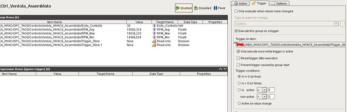

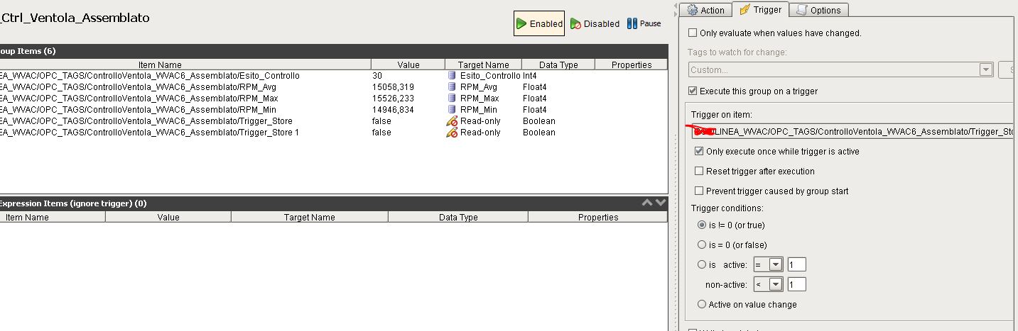

Hello I have a problem with transaction group!
I have a trigger with which I store data in a table of the DB.
Every time the trigger is true I store data but in the DB I found the same record 2 times!
Any idea?
Thank you
C.
 ![trigger](https://us1.discourse-cdn.com/inductiveautomation/original/2X/c/cd373bdd86d2b62b4e1980a6a8a7b292a6e035d8.jpeg)
 ![Cattura](https://us1.discourse-cdn.com/inductiveautomation/original/2X/c/c111b1b3c6c10d425f9ebac7889afc5b199bb457.jpeg)
**Author:** ![jpark](https://avatars.discourse-cdn.com/v4/letter/j/a88e57/32.png) [@jpark](https://forum.inductiveautomation.com/u/jpark)\
**Post date:** [May 20, 2019, 5:40pm UTC](https://forum.inductiveautomation.com/t/duplicated-record-on-db/25158/2 "2019-05-20T17:40:31Z")
Do you have a 2nd copy of the project somewhere?
**Author:** ![claudio](https://avatars.discourse-cdn.com/v4/letter/c/7cd45c/32.png) [@claudio](https://forum.inductiveautomation.com/u/claudio)\
**Post date:** [May 21, 2019, 7:14am UTC](https://forum.inductiveautomation.com/t/duplicated-record-on-db/25158/3 "2019-05-21T07:14:39Z")
Right consideration … it could be since some weeks ago I duplicated a project to make some changes!
Thank you so much.
