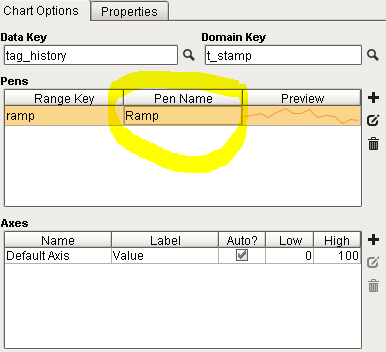

Hi Everybody
I need create a report with a time-series chart , with dynamic history pens.
I created a parameter for to pass coreectly the name of the pen , but I don’t find the right syntax to create the dynamic label for the pen.
 ![](https://us1.discourse-cdn.com/inductiveautomation/original/2X/c/cec0a01cb38a3607c7f06274af0b9f98286f1e6a.PNG)

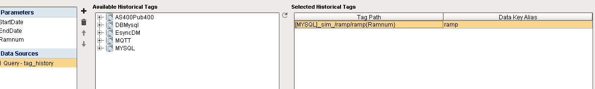

which is the right syntax to put in the Pen Name parameter?
![](https://us1.discourse-cdn.com/inductiveautomation/original/2X/9/9f443c36f50b423eaacc4b01d7b62f545252edd0.PNG) ( see picture below)
Thank you very much
Andrea
**Post date:** [April 20, 2017, 3:25pm UTC](https://forum.inductiveautomation.com/t/dynamic-label-for-a-time-series-chart-in-the-report/14090/2 "2017-04-20T15:25:30Z")
There isn’t a way to dynamically label the pens in a report, but it is possible using the configureChart extension function. Here’s a small example showing how to extend the JFreeChart objects:
