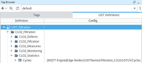

And the tags are located in these two folders. For example, the tag “Cycles” is located here :
![cycles](https://us1.discourse-cdn.com/inductiveautomation/original/3X/3/6/369a085bee3cdc6a579bee92650a53257a15fb53.png)
and then in my UDT I create a reference tag where I give the path of the tag (with “UDTName” a parameter that changes for each client) :
![UDT](https://us1.discourse-cdn.com/inductiveautomation/original/3X/e/9/e97a1f1aa338a266449fe97d414abfbda3ae58bf.png)
Same thing for all the tags. Then, when I create an instance of this UDT specifying the value of the missing parameters, I can access the value of the tags.
