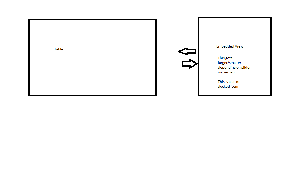

Hi All,
I'm trying to take an embedded view and use it as a "dock" screen. Meaning that I want to use a slider to increase/decrease its size on the screen. And based on that the breakpoint containers on the screen would change depending on how much its taking up. I was wondering if anybody has done this before? If so how did you do it?
Thanks!

**Author:** ![steven.hess](https://avatars.discourse-cdn.com/v4/letter/s/2acd7d/32.png) [@steven.hess](https://forum.inductiveautomation.com/u/steven.hess)\
**Post date:** [February 12, 2024, 9:43pm UTC](https://forum.inductiveautomation.com/t/dynamically-change-embedded-view-size/85558/3 "2024-02-12T21:43:24Z")
So yeah I want that resizable feature basically i want to be able to move the embedded view like a docked view but not "docked" if that makes sense. I attached a very very high level example of what I'm trying to do

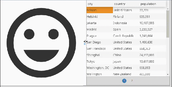

**Post date:** [February 12, 2024, 11:32pm UTC](https://forum.inductiveautomation.com/t/dynamically-change-embedded-view-size/85558/4 "2024-02-12T23:32:01Z")
Have you considered the Split Container component?
![](https://us1.discourse-cdn.com/inductiveautomation/original/3X/7/f/7f533bac3a9a7921d60a6b36471659a759615faf.gif)
[https://docs.inductiveautomation.com/display/DOC81/Perspective+-+Split+Container](https://docs.inductiveautomation.com/display/DOC81/Perspective+-+Split+Container)
**Post date:** [February 13, 2024, 12:01am UTC](https://forum.inductiveautomation.com/t/dynamically-change-embedded-view-size/85558/5 "2024-02-13T00:01:20Z")
@Transistor That would be exactly what I need! Sadly I'm running 8.1.17 and I'm not sure the client I'm doing this for will let me upgrade to 8.1.18 due to other projects on there.

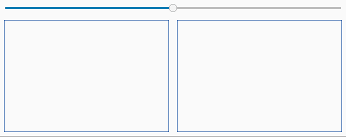

**Post date:** [February 13, 2024, 12:18am UTC](https://forum.inductiveautomation.com/t/dynamically-change-embedded-view-size/85558/6 "2024-02-13T00:18:49Z")
What root view type are we working with? (Flex / Coordintate, etc.)
**Post date:** [February 13, 2024, 12:50am UTC](https://forum.inductiveautomation.com/t/dynamically-change-embedded-view-size/85558/7 "2024-02-13T00:50:35Z")
Try pasting this view into Project Browser → Perspective → Views.

![DIY Split Container](https://us1.discourse-cdn.com/inductiveautomation/original/3X/9/3/93dc7caad8b6bc2e20a7ed0d40a91d68a2067ef7.gif)
Notes:
- The view is a flex column.
- The slider has a bidirectional binding to the view's `props.custom.split`. (That avoids messy and brittle bindings from the next step.)
- The slider is followed by a Flex Row into which two Embedded View components are added. They have the following settings:
`position.shrink : 0`
`position.basis : 20px` (Set this to whatever minimum width you want.)
- The relative weights of the `position.grow` properties determine the relative widths of the embedded views. For simplicity we set the one on the right to `position.grow : 1`.
- The embedded view on the left has its `position.grow` calculated by an expression binding:
`{view.custom.split} / (100 - {view.custom.split})`
So, if the slider is at 75 of 100 the result is 75 / (100 - 75) = 3 giving us a 3:1 ratio between the views.
If the slider is at 25 of 100 the result is 25 / (100 - 25) = 1/3 giving us a 1:3 ratio between the views.
I suggest binding the slider's `props.trackColor` to its `props.railColor` and specifying a neutral color for the rail. Having different colors each side of the slider knob (as in my animation) doesn't make any visual sense in this application.
Have fun.
**Post date:** [February 13, 2024, 1:50am UTC](https://forum.inductiveautomation.com/t/dynamically-change-embedded-view-size/85558/8 "2024-02-13T01:50:58Z")
> [@Transistor](#):
You are a gentleman and a scholar. This works perfectly! Thanks
