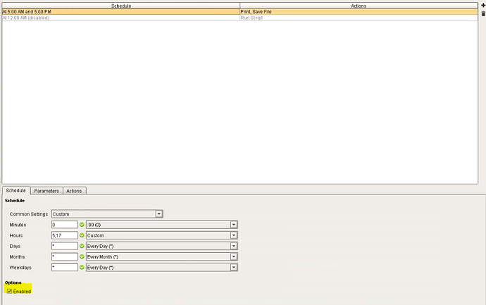

I’d like to see if there is a good way to dynamically control the enabled property of reports based on a boolean tag:
 ![image](https://us1.discourse-cdn.com/inductiveautomation/original/2X/1/1e5a6ee31e159d2fcf6d8cc94afc008136d19e1d.png)

Currently, there isn’t a way to do this with the built-in interface.
However, you could use a Run Script action (under the Actions tab), write a script that would check your Boolean tag, and call [system.report.executeAndDistribute](https://docs.inductiveautomation.com/display/DOC79/system.report.executeAndDistribute).
