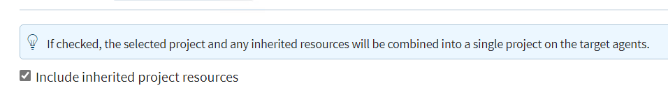

![image](https://us1.discourse-cdn.com/inductiveautomation/original/3X/7/f/7f3727a9b7b1320a63c08f7bd1b23cf3558da8c7.png)
If you want to send a project and inherited projects with EAM, it looks like it will smoosh it all into a single project... this seems a bit silly - why would anyone want to do this?
I wish the project selections were checkboxes and not radio buttons so you can actually send multiple projects. If I have a number of projects, it means having to set up many "Send Project" tasks which is cumbersome
**Post date:** [November 25, 2022, 2:36pm UTC](https://forum.inductiveautomation.com/t/eam-send-project-inherited-combines-projects/66906/2 "2022-11-25T14:36:19Z")
> [@nminchin](#):
To target Edge devices.
