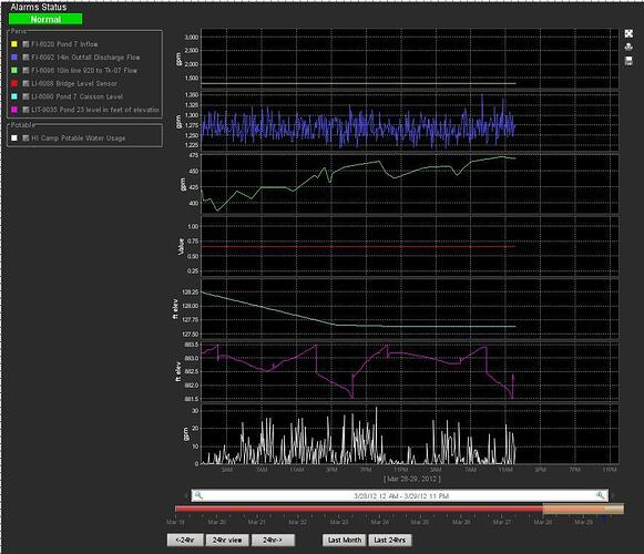

This is really three feature requests, one to arrange the labels on the legend so that they correspond to the trend position in the subplots.
the second is to make a true isolated graphing mode available without having to create multiple subplots
For example, on RSView32 we make extensive use of isolated graphing. This mode is not available in the Ignition Easy Chart Control but provides a quick and easy way of viewing trends with radically different scales (i.e. flow = 0-2000 GPM, ph = 7-10 pH) on the same plot. The nice thing about this is that the legend created by the RSView32 trendx control has the tag descriptions listed in the same order as the trends on the plot. This means that the plot is still discernable if you print the trend to black and white
Conversely if you create an easy trend the legend will list the pens in alphabetical order, so you need to juggle the sub plot order to try and get the legend labels and the trends to match. This leads to some not so logical orderings of sub plots. Perhaps a better way of doing it would be to order the labels on the legend by sub plot position first and then by alphabetical order.
Yes I could just place my own legend box in but this is a pain and it would be nice if it just ‘worked’ right in the first place.
Alternatively you could provide an isolated graphing checkbox to allow the trend to act in the same way as Trendx (i.e. without configuring subplots), this way the trend legend could just display them as they appear. A way of moving trends up and down in their order would have to be provided.
Third feature request:
The use of subplots currently uses quite a lot of screen real estate (I’m talking about the 5 pixels or so between sub plots). This isn’t really functional and consumes space which becomes an issue when you are trying to squeeze a small plot with 2-3 subplots on it into a small area. If this could be eliminated this would be great (just a one pixel line is fine).

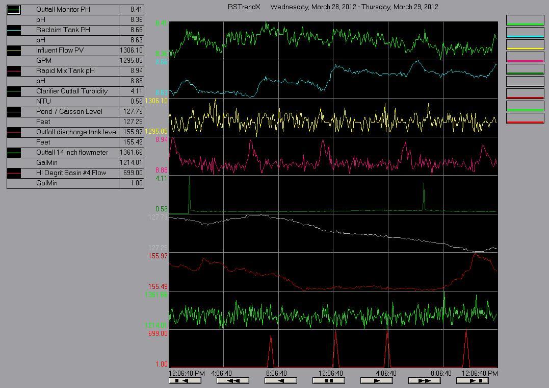

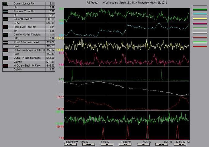

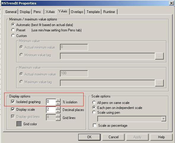

The ‘trendx alternative’ is basically a method in RSTrendx of selecting an ‘isolated graphing’ checkbox and the trends are automatically displayed on their own subplots with auto scaling (exact scaling can be overridden using the pen configuration). This requires no subplot specification.
Yes you have more control with the way Ignition does things but RSTrendX is quicker in terms of being able to put trends together although lacking things like sub plot relative weighting etc.
Also the RSTrendX equivalent of xtrace gives all values across all subplots which would be great to see in Ignition (I think there is already a feature request out there)
For for early 2000s era software RSTrendX is actually pretty slick! I’ve included some screen shots of RSTrendx trends, config, and Ignition subplots to illustrate this.
That reminds me of another feature request I put in to delink the xaxis font and legend label color from the time scale selector box. What a pain for dark backgrounds! (Notice the grey font I am forced to use in the Ignition trend screen shot)

1. “Isolate Graphs”. An Expert property of the Easy chart that, when enabled, divides the chart into n even subplots, where n is the pens. I recommend not overriding axis settings, except making all axis labels appear on the left side. It seems like an odd feature to me, but could be useful for others.

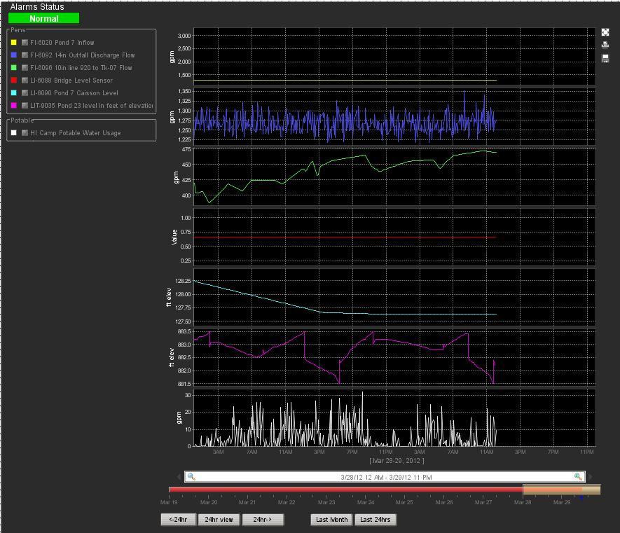

As a temporary work around for others trying to figure out how to get the trend legend names to match the trends in the same order on trends with multiple subplots
1. unselect the alphabetize pens option as discussed previously (expert section)
2. modify the pen names to start with “A/” “B/” etc
i.e
A/AI-6027 Reclaim Tank pH
B/AI-6085 Outfall Monitor pH
C/…
D/…
etc
This has the effect of creating groups (one for each pen). I usually will use one group for each subplot. i.e A/ is for subplot 1, B/ for subplot 2 etc. So long as you don’t have the “Group Pens” option selected then this should work fine
