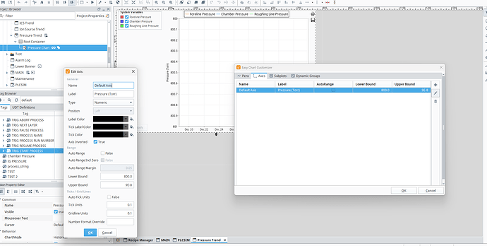

I have an Easy Chart that is setup to read pressures from various sensors. The question I have is reference to the axis and how I can best show this data. These pressures are all measured in Torr, so I would expect a range from 780’s (atmosphere) down to a high vacuum level (9.99E-8). Here’s my current setup:
 ![image](https://us1.discourse-cdn.com/inductiveautomation/original/3X/f/2/f298c2a92268f7a2d86977864c19a27929b0d276.png)
How can I create a range for my chart to display these wide ranges of data? I’d ideally like to have this showing a range from 1000 torr all the way to down to 1.0E-9 with major increments every decade all the way down to the low.
**Post date:** [January 5, 2026, 12:45pm UTC](https://forum.inductiveautomation.com/t/easy-chart-customizer-for-high-vacuum-pressures/113066/2 "2026-01-05T12:45:28Z")
You need a logarithmic axis. See this topic:
