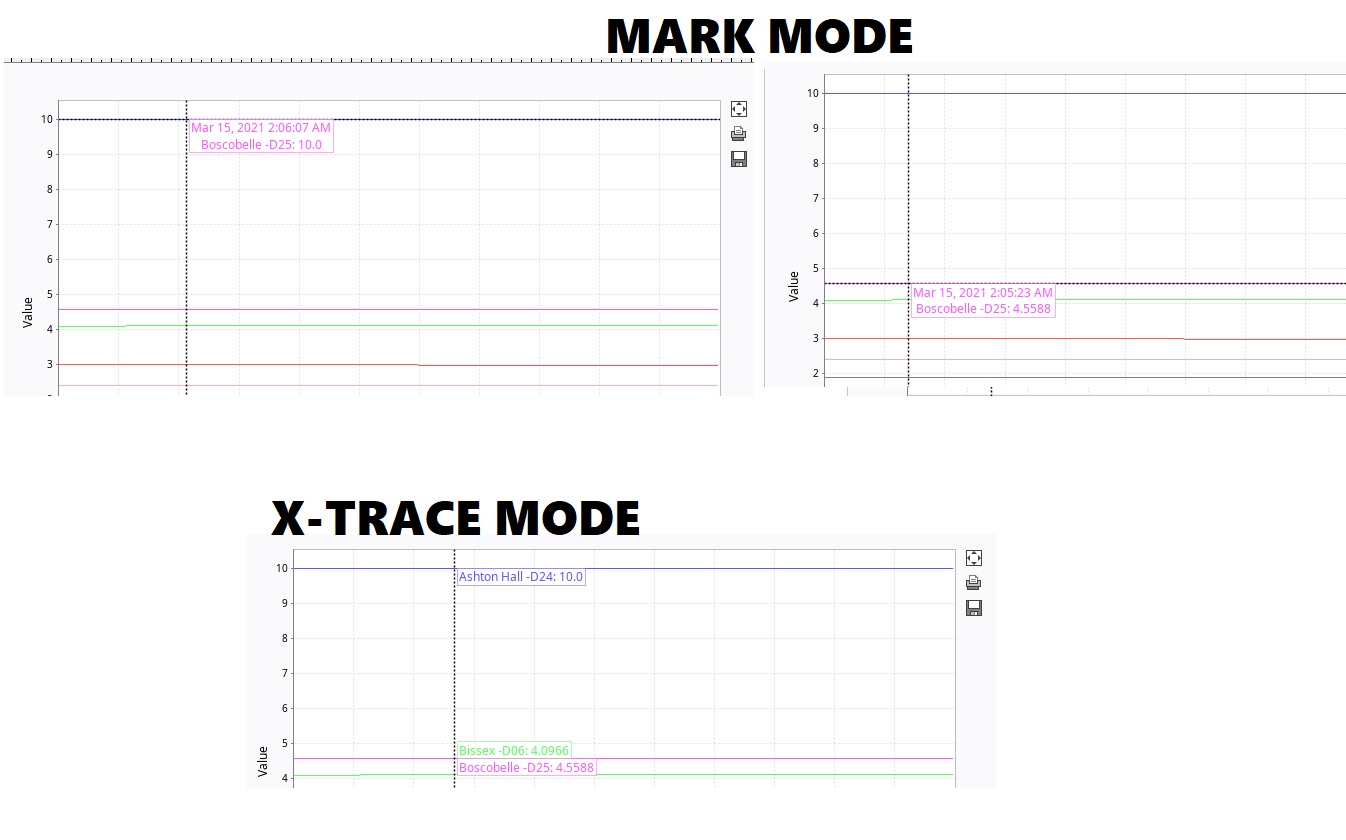

I have a weird problem with the easy chart component, when I put it in mark mode, the thoughts appear with thwith the same name always
 ![EASYCHART](https://us1.discourse-cdn.com/inductiveautomation/original/3X/4/e/4ed3c3e396ca991b7d4241cfdc79df3d19c99651.jpeg)
**Post date:** [March 15, 2021, 12:47pm UTC](https://forum.inductiveautomation.com/t/easy-chart-error-mode-mark/44462/2 "2021-03-15T12:47:16Z")
Mark mode is for the closest point on any pen, displaying that pen and value. Try clicking near the green line.
**Author:** ![lachguerabdallah](https://sea1.discourse-cdn.com/inductiveautomation/user_avatar/forum.inductiveautomation.com/lachguerabdallah/32/25558_2.png) [@lachguerabdallah](https://forum.inductiveautomation.com/u/lachguerabdallah)\
**Post date:** [March 15, 2021, 1:43pm UTC](https://forum.inductiveautomation.com/t/easy-chart-error-mode-mark/44462/3 "2021-03-15T13:43:43Z")
the fault is only in the name it shows, the value is correct
