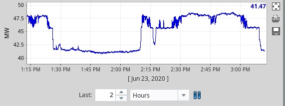

Good day,
When I am programming in the Designer, the Easy Chart runs okay. But when running on the Client, the chart will get error of database query.
This is the diagnostic I run on the Easy Chart.
PenSQLQuery “SELECT t\_stamp, pal2\_generator\_active\_power\_total FROM nigbu\_load WHERE t\_stamp \>= ? ORDER BY t\_stamp”: Good
I don’t understand where the t\_stamp get the ? value.
Screenshot was on the Designer.
 ![screenshot1](https://us1.discourse-cdn.com/inductiveautomation/original/3X/6/8/68995c5ec5a554a219dc8d21b6b4ad3d4bc33280.jpeg) !
Screenshot was on the Client
[screenshot2|577x218](https://forum.inductiveautomation.com/uploads/short-url/owTZ9WfKYCLn50x8wuy0Onh4Mmd.jpeg)
Thank you very much. Any help would be much appreciated.

Hi,
Since you are running your Easy Chart in RealTime, the query syntax is automatic.
I believe the “?” value is just the current date minus the time configured under the Chart (in your case 2 hours).
The fact that the Easy Chart does not run in Client is probably a Project Property issue.
In the designer, go to Project/Properties under Client/Permissions make sure that Legacy Database Access is enabled.
 ![image](https://us1.discourse-cdn.com/inductiveautomation/original/3X/6/d/6d7c77ec3ca00a4543efe6b4e9394240a761476f.png)
If not, check it and save your project.
