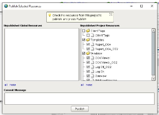

Have a project in production. Have some unpushed changed in queue that I don’t know what was changed and don’t want to push -
![image](https://us1.discourse-cdn.com/inductiveautomation/original/3X/3/6/36d61a7b2f832558a5c9eedc5606e15d231926f9.png)
I figure I could export the “Published” version from the gateway and reimport it over on top of the existing version to make these staged changes go away. I was wondering if there’s another way to do this as well without exporting/re-importing the project?

I would export, re-import, then disable staging. It is completely gone in v8+, so you might as well get used to not having it.

Oh you can disable it? Does that equate to setting the publisher setting to “Auto” in the project properties?

Yes.
