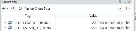

I am using memory tags to set EasyChart displayed data range.
DateTime type tags, batch start and end time.
![image](https://us1.discourse-cdn.com/inductiveautomation/original/3X/9/3/9398bc4db8b22cdc83a582b782da124cf161cc5c.png)
Everything works OK when I use gateway tags.
However I would like to use client tags to allow multiple users to analyze different batches at the same time. But when I connect EasyChart range to [client] tags, chart time range does not update, it displays last 10 minutes.
Both client and gateway tags have the same values.
 ![image](https://us1.discourse-cdn.com/inductiveautomation/original/3X/5/0/501bb0f232980cd33c2225c99d1263ad733f3c67.png)
 ![image](https://us1.discourse-cdn.com/inductiveautomation/original/3X/c/1/c11abb094b46bb2c5851df5a1dbc301ff1e74bbf.png)
 ![image](https://us1.discourse-cdn.com/inductiveautomation/original/3X/4/2/4259fed2d42784bf049e580e8b4d803b87a35836.png)
**Post date:** [April 11, 2022, 2:56pm UTC](https://forum.inductiveautomation.com/t/easychart-start-end-date/58293/2 "2022-04-11T14:56:01Z")
Try _ **not** _ using bindings. Simply have whatever scripting you are using for your batch selection write the correct datetime values directly to those properties.
