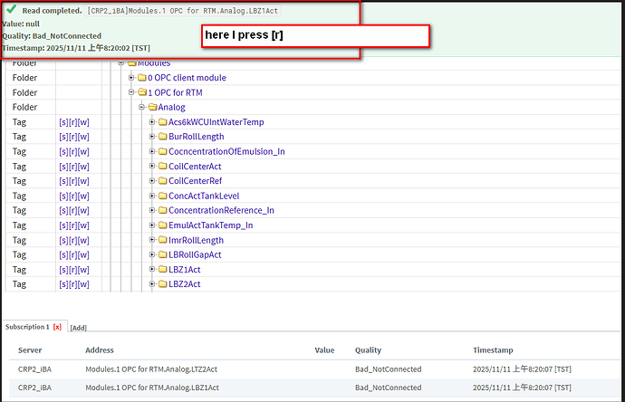

Dear sir:
I’m a beginner and would like to ask for help from the experts.
I connected to an OPC Client from Edge using the OPC DA method. The OPC Client passes tag information obtained from the OPC Server to Edge.
However, I can only get the tag names in edge but not their values. Could any expert please help me understand why this is happening?

**Post date:** [November 11, 2025, 12:26am UTC](https://forum.inductiveautomation.com/t/edge-can-get-opc-tag-name-but-can-not-get-value/112086/2 "2025-11-11T00:26:25Z")
Some OPC DA servers are buggy, and don't do "subscribe" properly. Try the `[r]` to see if you can do a poll read. If so, set an Ignition tag group to use OPC Reads instead of subscriptions and put the tags in this group.

**Post date:** [November 11, 2025, 12:40am UTC](https://forum.inductiveautomation.com/t/edge-can-get-opc-tag-name-but-can-not-get-value/112086/4 "2025-11-11T00:40:35Z")
Dear sir: I press [r] and show bad\_notconnected

**Post date:** [November 11, 2025, 1:17pm UTC](https://forum.inductiveautomation.com/t/edge-can-get-opc-tag-name-but-can-not-get-value/112086/6 "2025-11-11T13:17:30Z")
Someone else with have to chime in. You've exhausted my knowledge of OPC DA problems and my willingness to work on anything related to Windows.
**Author:** ![Cody\_Morgan](https://avatars.discourse-cdn.com/v4/letter/c/db5fbb/32.png) [@Cody\_Morgan](https://forum.inductiveautomation.com/u/Cody_Morgan)\
**Post date:** [November 11, 2025, 5:49pm UTC](https://forum.inductiveautomation.com/t/edge-can-get-opc-tag-name-but-can-not-get-value/112086/7 "2025-11-11T17:49:55Z")
It sounds like you're hitting this problem described in the user manual:
[connection-status-is-connected-but-data-quality-is-bad-or-the-connection-goes-faulted-after-trying-to-read-tag-data](https://www.docs.inductiveautomation.com/docs/8.3/ignition-modules/opc-ua/third-party-opc-servers/opc-com#connection-status-is-connected-but-data-quality-is-bad-or-the-connection-goes-faulted-after-trying-to-read-tag-data)
That section references this section on how to configure DCOM settings on the Ignition machine:
> **[OPC COM | Ignition User Manual](https://www.docs.inductiveautomation.com/docs/8.3/ignition-modules/opc-ua/third-party-opc-servers/opc-com#ignition-server-dcom-settings)**
> Connecting to OPC Classic (COM)
I have never had to deal with COM, but the security settings described in the user manual seem very loose. I'd imagine that it could be locked down a little tighter, but start with the recommendations in that section before trying to tighten down the permissions.
**Author:** ![chentaoko](https://avatars.discourse-cdn.com/v4/letter/c/e79b87/32.png) [@chentaoko](https://forum.inductiveautomation.com/u/chentaoko)\
**Post date:** [November 13, 2025, 2:43am UTC](https://forum.inductiveautomation.com/t/edge-can-get-opc-tag-name-but-can-not-get-value/112086/8 "2025-11-13T02:43:39Z")
It works! thanks so much, sir
