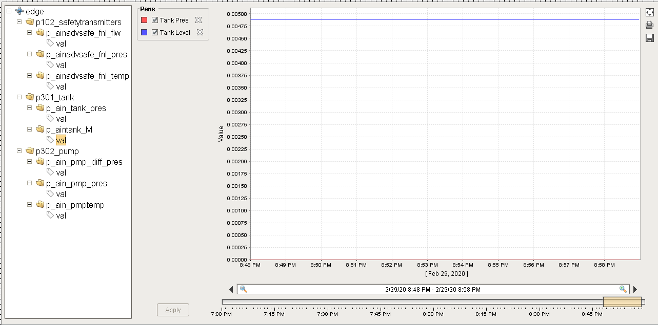

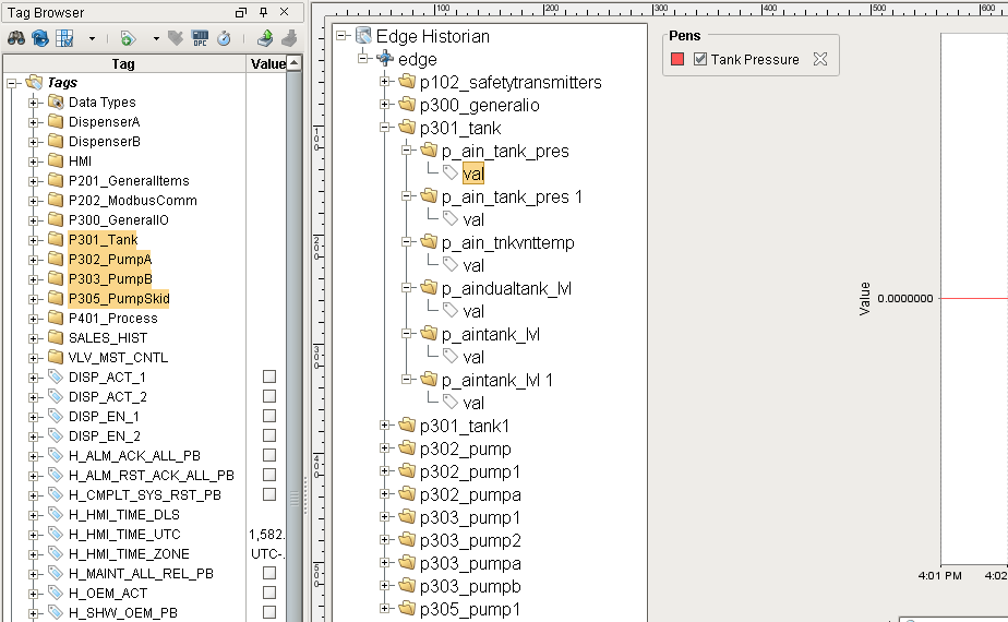

Item 1:
Currently, in my Tag Browse Tree, I have many folders and tags that don’t exist in the system. Some look to be copies of existing ones with " 1" added to the end, and some of them are from another project that I was developing on this machine. I did a full gateway restore when I switched back to this project.
Is there someway to clean up this data? Or completely clear all history? This is just my dev machine so I’m not worried about saving any of the history.
Here is a screen shot. I should only have the 4 highlighted folders in my tag list in the tree.
 ![image](https://us1.discourse-cdn.com/inductiveautomation/original/2X/4/4cb5d240fc41238f25d5f2295f07a8c481355913.png)

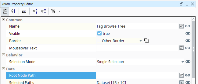

For item 1, I'm guessing clearing out the DB would remove the old tags--I haven't tested this though.
> [@Dmart](#):
> Item 2:
> Is there any control on simplifying the look of the Tag Browse Tree?
If you can put all the folders you want to display into one parent folder, set that root node path to the tag path to that folder (right click on folder and copy tag path in tag browser) and the Tag Browse Tree component will then only show what is under the node you set here:
 ![image](https://us1.discourse-cdn.com/inductiveautomation/original/2X/6/6f01421b03f8bed860b08ae7fd3581f8dfd0fc96.png)

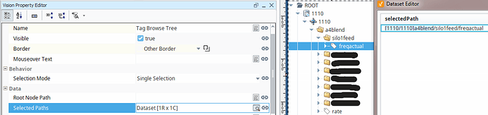

**EDIT** : The above works for realtime tags. For historical tags, you can get the root node path to a folder by selecting a tag in the folder you want to display at the top level in the tag browse tree in preview mode and then looking at the selected paths dataset in the properties to get the path.
 ![image](https://us1.discourse-cdn.com/inductiveautomation/original/2X/7/70f712be3e82afec3456d7833e20131eee8beda2.png)
If I set the root node path in the properties to the selected path in the dataset editor, "a4blend" becomes the top level in the Tag Browse Tree.

Item 1:
Yeah, I’m thinking about trying to just delete the following file. (actually move to temp spot, in case it breaks)
C:\Program Files\Inductive Automation\Ignition\data\edge\_data\edge\_historian.idb

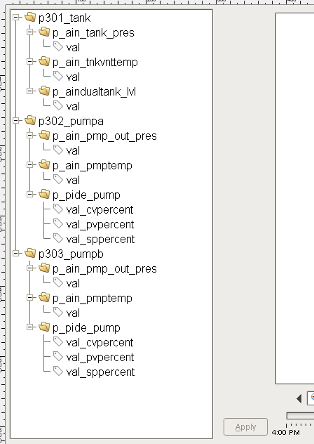

Item 2:
Unfortunately changes to the file structure aren’t really possible. That would break a lot of other stuff…
But with what you suggested, I was able to put ‘[Edge Historian/edge]’ in the Root Node Path and at least remove the top two lines.
 ![image](https://us1.discourse-cdn.com/inductiveautomation/original/2X/c/c074014c8ece33bc75b2130b7ef0141665f2ded0.png)

1. That sounds like the right file to delete. Backup is always a good idea, but I’m pretty sure it will recreate it.

1. Deleting that file did the trick… (and didn’t break anything.)
2. I had thought about making copies in a different folder, but I also have a sparkline on my AIn faceplate that is tied to the historian with indirection.
Well, thanks to your help, things do look better. At at least I can expand everything and it fits without having to scroll.
 ![image](https://us1.discourse-cdn.com/inductiveautomation/original/2X/6/676afc080a1723da07e741934d1a43496b807674.png)

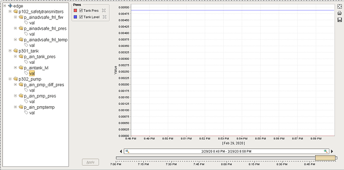

Old screen:
 ![image](https://us1.discourse-cdn.com/inductiveautomation/original/2X/0/0bd2329b21f53c16e6b191f7ec0541c355270dcb.png)
