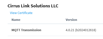

**Author:** ![Andres\_Rossi](https://avatars.discourse-cdn.com/v4/letter/a/87869e/32.png) [@Andres\_Rossi](https://forum.inductiveautomation.com/u/Andres_Rossi)\
**Post date:** [July 18, 2024, 8:03pm UTC](https://forum.inductiveautomation.com/t/edge-panel-mqtt-store-forward-missing-value-changes/93421/10 "2024-07-18T20:03:00Z")
4.0.21 version
![imagen](https://us1.discourse-cdn.com/inductiveautomation/original/3X/3/a/3a39f9056ebcb884c39f97c0031ffc81180a892f.png)
