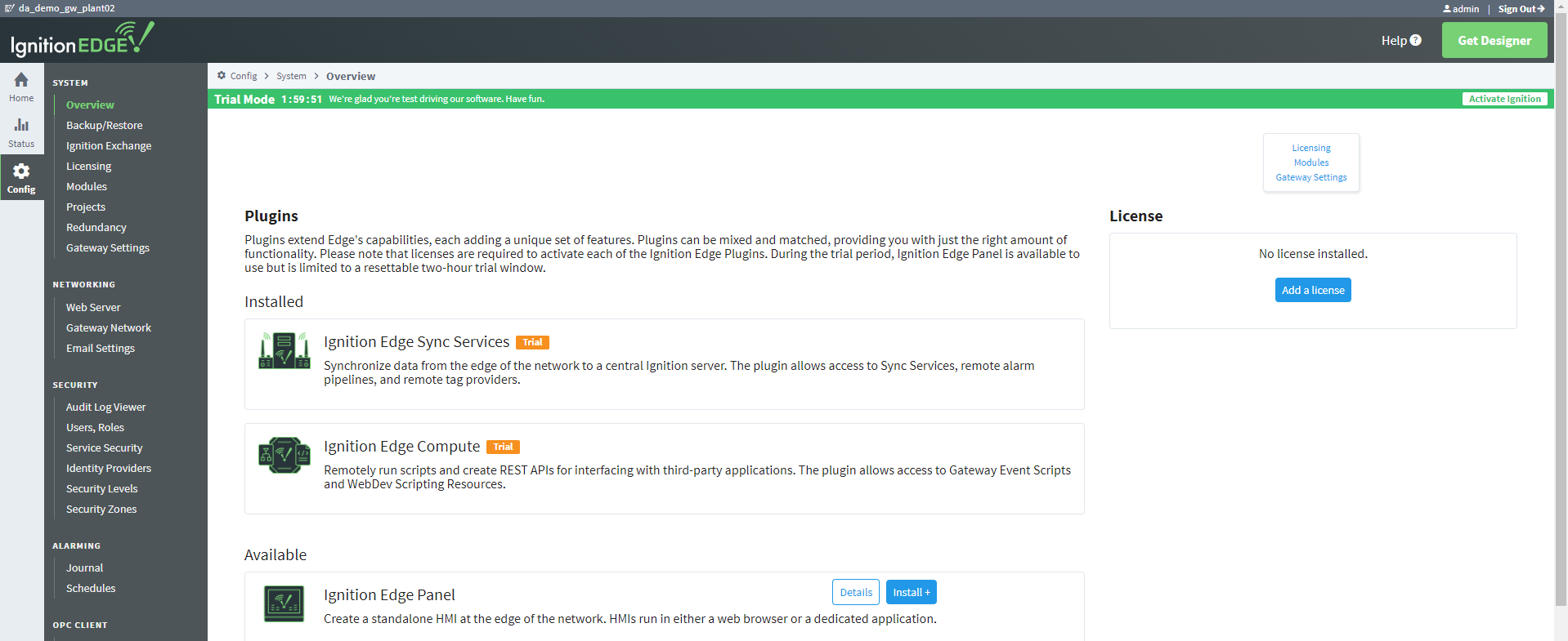

Could you post (or dm me) a screen shot of where it shows Edge Compute is licensed? That definitely doesn’t sound right and it would help me to recreate the issue. Thanks!

To be clear I have not yet licensed anything, that is a business decision to be made later. I am just in a development/sales mode right now. I’ll buy a license when I get a PO from my customer, but first I must demonstrate a working trial system.
I just want the Edge Compute plug removed. Having more installed than what is needed is a red flag, I would like to set this up in trial mode exactly as I intend to install it .If it matters the OS is Lubuntu v20.04 running on a VMWare virtual machine, so it was a Linux install.
Some screenshots are below, I will gladly email you any files you desire, including the entire gateway backup if you wish.

Ah, gotcha.
There’s no way to make that go away except for licensing Edge. It shows as in trial because you _could_ run gateway scripts if you had any (although they wouldn’t be easy to load).
Sync services shows as in trial because they also will work – they don’t require any modules. That will also go away by applying a license.

**Author:** ![lane.duncan](https://sea1.discourse-cdn.com/inductiveautomation/user_avatar/forum.inductiveautomation.com/lane.duncan/32/83700_2.png) [@lane.duncan](https://forum.inductiveautomation.com/u/lane.duncan)\
**Post date:** [July 10, 2020, 3:31am UTC](https://forum.inductiveautomation.com/t/edge-plugins-testing/33979/12 "2020-07-10T03:31:47Z")
> [@KathyApplebaum](#):
Thank you for the clarification Kathy.
> [@pturmel](#):
> Consider getting a time-limited license for use during your demonstration period. Your sales agent at IA can help.
I will do this eventually. From a sales perspective I think its important to understand the limitations/differences of trial mode, especially for issues like this. One habit I have been getting into is removing modules I don't think I need, just to prevent any surprises like this.
In my opinion adding a license should not remove functionality. Personally I would prefer the edge compute plug-in (and gateway scripting) not be enabled if the proper modules are not installed. In this particular case it's not a big problem, but it is a difference in operation between trial mode and licensed mode, which is a big red flag for people used to dealing with software companies that do this frequently.
