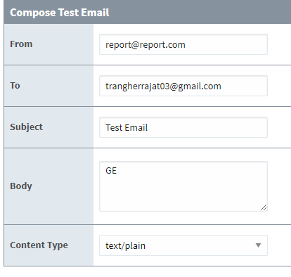

Dear all
iam having this error when i tried to test my email notification
regards
javax.mail.MessagingException: Could not connect to SMTP host: [smtp.gmail.com](http://smtp.gmail.com), port: 465;
nested exception is:
java.net.SocketException: java.security.NoSuchAlgorithmException: Error constructing implementation (algorithm: Default, provider: SunJSSE, class: sun.security.ssl.SSLContextImpl$DefaultSSLContext) ![ques](https://us1.discourse-cdn.com/inductiveautomation/original/2X/c/c49e73e7ca5a00944ef2577f5e968e1c9fa868b2.png)

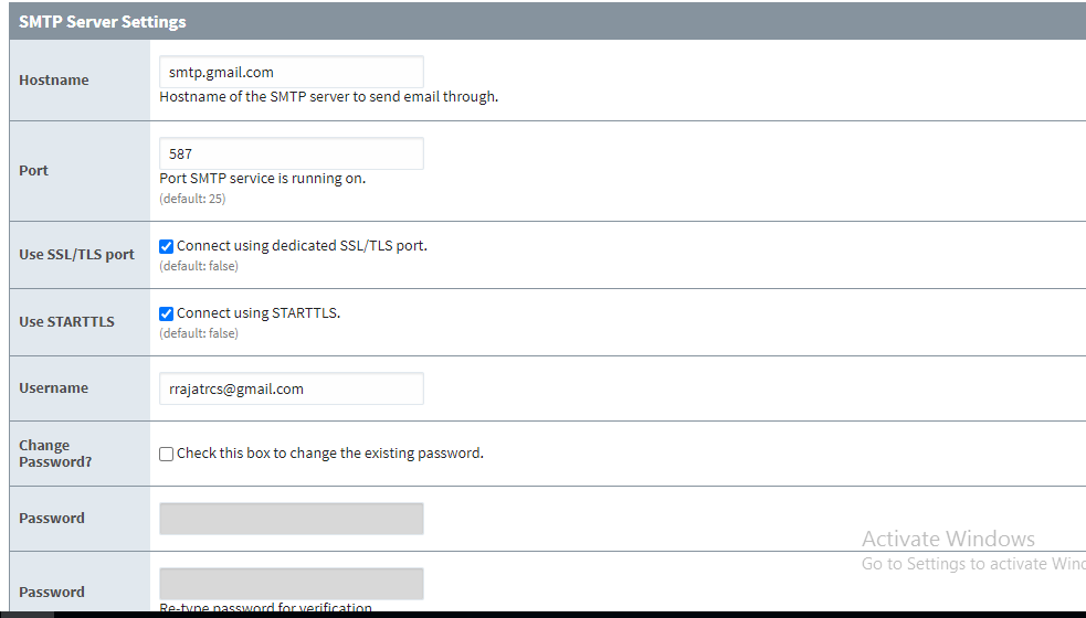

**Post date:** [May 25, 2020, 1:02pm UTC](https://forum.inductiveautomation.com/t/email-notification-error/35007/2 "2020-05-25T13:02:23Z")
On the SMTP profile settings, try enabling SSL/TLS if not already enabled, and also try port 587 instead.
**Author:** ![rrajatrcs](https://avatars.discourse-cdn.com/v4/letter/r/278dde/32.png) [@rrajatrcs](https://forum.inductiveautomation.com/u/rrajatrcs)\
**Post date:** [May 28, 2020, 3:41am UTC](https://forum.inductiveautomation.com/t/email-notification-error/35007/3 "2020-05-28T03:41:32Z")
javax.mail.MessagingException: Could not connect to SMTP host: [smtp.gmail.com](http://smtp.gmail.com), port: 587;
 ![Capture1](https://us1.discourse-cdn.com/inductiveautomation/original/2X/5/5cd4b7baec4202fa83537fdd55e311d96edd34b2.png)
