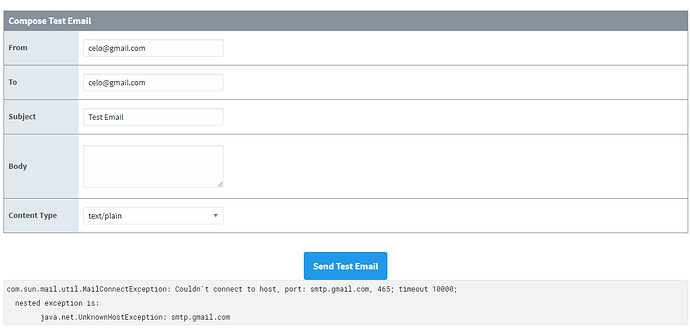

I use gmail for Email Setting
 ![image](https://us1.discourse-cdn.com/inductiveautomation/original/3X/e/8/e8832076bd92661429d9bb6df59454449c525cb7.png)
But why I got this message, my computer can't find the sever?
 ![image](https://us1.discourse-cdn.com/inductiveautomation/original/3X/a/c/ac3c509b2b2e910177ab81ae2b9a20f1a0c94135.png)
**Post date:** [March 18, 2024, 9:59am UTC](https://forum.inductiveautomation.com/t/emailnotificationerror/87452/4 "2024-03-18T09:59:00Z")
And have you set a valid username and password so that Ignition can authenticate with the Gmail server?
Can you ping [smtp.gmail.com](http://smtp.gmail.com) from your gateway?

**Author:** ![celo\_Tu](https://avatars.discourse-cdn.com/v4/letter/c/e9bcb4/32.png) [@celo\_Tu](https://forum.inductiveautomation.com/u/celo_Tu)\
**Post date:** [March 18, 2024, 10:23am UTC](https://forum.inductiveautomation.com/t/emailnotificationerror/87452/5 "2024-03-18T10:23:57Z")
Thank you for reply!
No, this is not my personal email just for example
Yes I can ping the [smtp.gmail.com](http://smtp.gmail.com/)
 ![image](https://us1.discourse-cdn.com/inductiveautomation/original/3X/3/0/30f1a8b59c303868822b0354b20b35594df8f6d7.png)
So I need to set a password by google setting for ignition?
**Post date:** [March 18, 2024, 11:00am UTC](https://forum.inductiveautomation.com/t/emailnotificationerror/87452/6 "2024-03-18T11:00:45Z")
Gmail generally doesn't permit simple user/password authentication now-a-days. You must use OAuth, and preconfigure it in gmail.
(You really should use a corporate email server or you will suffer.)
