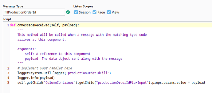

I have Text input filed which is embedded. On this embedded view onchange script is bound to value parameter. But when I change value parameter using python the embedded view is not refreshed and onchange script is not fired even though in logs it shows that value has been updated. What am I doing wrong ? When I manually fill some characters to the text field everything works.

did you mark the view param(in the embedded view) as input + output?
(highlighted one)

I found that on change scripts don’t fire on params. I bind value to custom props. Maybe victor’s way works too?

one step closer - I bind text property of text input to the param and text is updating but onchange is not firing

is the binding bidirectional?
is the viewparam bidirectional?

This is a message handler which receives value and sets value param
 ![image](https://us1.discourse-cdn.com/inductiveautomation/original/3X/8/c/8cfdc431e41ebddfa3585f352e00ccc03826e462.png)

I tried also changing param isValid to true programatically but nothing happened.
EDIT:
Okay this is really weird, now I set isValid param to True again and suddenly its working
`self.getChild("ColumnContainer").getChild("productionOrderIdFlexInput").props.params.isValid = True`
