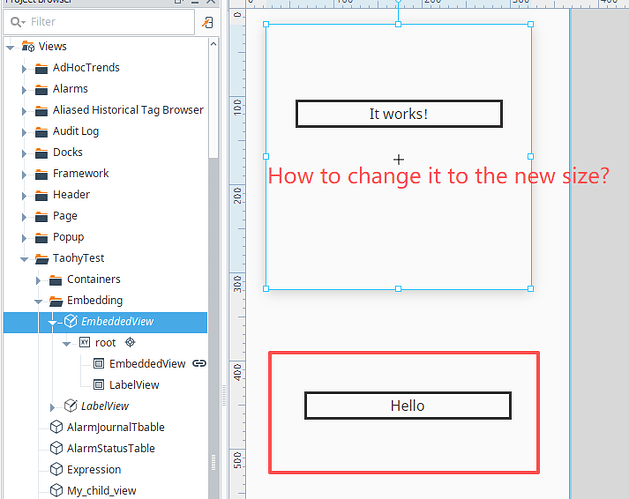

If I add a embedded view in view, it has default size width=300 and height=300.
 ![image](https://us1.discourse-cdn.com/inductiveautomation/original/3X/7/9/79ff89e2f757a33b72627722e1c64473f8123008.png)
But I need to change Embedded View’s size again,width=200 height=300.
But the old embedded view’size is also 300 and 300, it doesn’t update the new size.
I have to change it by hand , Is there easy way to update it?
**Post date:** [September 11, 2025, 1:02pm UTC](https://forum.inductiveautomation.com/t/embedded-view-change-size/110530/2 "2025-09-11T13:02:54Z")
I think you have not explained the problem clearly. Can you edit your post (pencil icon) to clarify what the problem is and what your image is supposed to show us?
**Post date:** [September 11, 2025, 3:37pm UTC](https://forum.inductiveautomation.com/t/embedded-view-change-size/110530/3 "2025-09-11T15:37:51Z")
No, there's no mechanism in Ignition to automatically update all the embedded instances of a view to its new default sizes.
There's a long list of reasons why we don't, but if you _really_ want to do that, views are just json files on disk. You could theoretically use a tool like [`jq`](https://jqlang.org/) on the command line to automatically update all of your `view.json` files after you made a change to an embedded view.
**Author:** ![Ryan\_Deardorff](https://sea1.discourse-cdn.com/inductiveautomation/user_avatar/forum.inductiveautomation.com/ryan_deardorff/32/63815_2.png) [@Ryan\_Deardorff](https://forum.inductiveautomation.com/u/Ryan_Deardorff)\
**Post date:** [September 11, 2025, 3:46pm UTC](https://forum.inductiveautomation.com/t/embedded-view-change-size/110530/4 "2025-09-11T15:46:05Z")
If you put the views into a Flex container instead of Coordinate, then the `useDefaultViewWidth` and `useDefaultViewHeight` properties should work.
