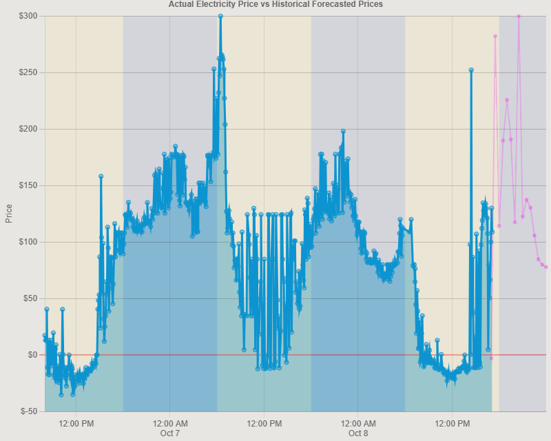

# Show Day/Night Colour Banding
_Source: Claude.ai, prompt: "chart.js. I want to show background colours on a line timeseries chart that shows different bg colours based on the time of day (night/day)"_
Add a new array item under `props.plugins` and paste the below into the new item:
```python
  "events": [
    "mousemove",
    "mouseout",
    "click",
    "touchstart",
    "touchmove"
  "id": "dayNightBackground",
  "beforeDatasetsDraw": "(chart) \u003d\u003e {\n // Helper function to draw a time block\n const drawTimeBlock \u003d (ctx, xScale, startTime, endTime, color, left, right, top, bottom) \u003d\u003e {\n const startX \u003d Math.max(xScale.getPixelForValue(startTime.getTime()), left);\n const endX \u003d Math.min(xScale.getPixelForValue(endTime.getTime()), right);\n\n if (startX \u003c endX) {\n ctx.fillStyle \u003d color;\n ctx.fillRect(startX, top, endX - startX, bottom - top);\n }\n };\n const {\n ctx,\n chartArea: {\n top,\n bottom,\n left,\n right\n },\n scales: {\n x\n }\n } \u003d chart;\n\n ctx.save();\n\n // Get the time range\n const minTime \u003d x.min;\n const maxTime \u003d x.max;\n\n // Iterate through each day in the range\n let currentDate \u003d new Date(minTime);\n currentDate.setHours(0, 0, 0, 0);\n\n while (currentDate.getTime() \u003c maxTime) {\n // Night period: 00:00 - 06:00\n const nightStart \u003d new Date(currentDate);\n nightStart.setHours(0, 0, 0, 0);\n const nightEnd \u003d new Date(currentDate);\n nightEnd.setHours(6, 0, 0, 0);\n\n drawTimeBlock(ctx, x, nightStart, nightEnd, \u0027rgba(30, 58, 138, 0.1)\u0027, left, right, top, bottom);\n\n // Day period: 06:00 - 18:00\n const dayStart \u003d new Date(currentDate);\n dayStart.setHours(6, 0, 0, 0);\n const dayEnd \u003d new Date(currentDate);\n dayEnd.setHours(18, 0, 0, 0);\n\n drawTimeBlock(ctx, x, dayStart, dayEnd, \u0027rgba(252, 211, 77, 0.1)\u0027, left, right, top, bottom);\n\n // Night period: 18:00 - 24:00\n const eveningStart \u003d new Date(currentDate);\n eveningStart.setHours(18, 0, 0, 0);\n const eveningEnd \u003d new Date(currentDate);\n eveningEnd.setHours(23, 59, 59, 999);\n\n drawTimeBlock(ctx, x, eveningStart, eveningEnd, \u0027rgba(30, 58, 138, 0.1)\u0027, left, right, top, bottom);\n\n // Move to next day\n currentDate.setDate(currentDate.getDate() + 1);\n }\n\n ctx.restore();\n};\n"
Example (banded pale yellow / pale blue vertical bands):
 ![image](https://us1.discourse-cdn.com/inductiveautomation/original/3X/c/4/c4ef5b12cab3cfbc3c510d985900418d1429b707.png)
PS. I'm showing the Source of where I derived the solution so that others like me who aren't javascript-fluent can see where I got my solution from! (I haven't written any more than 2% of the code myself)
