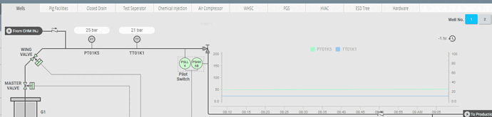

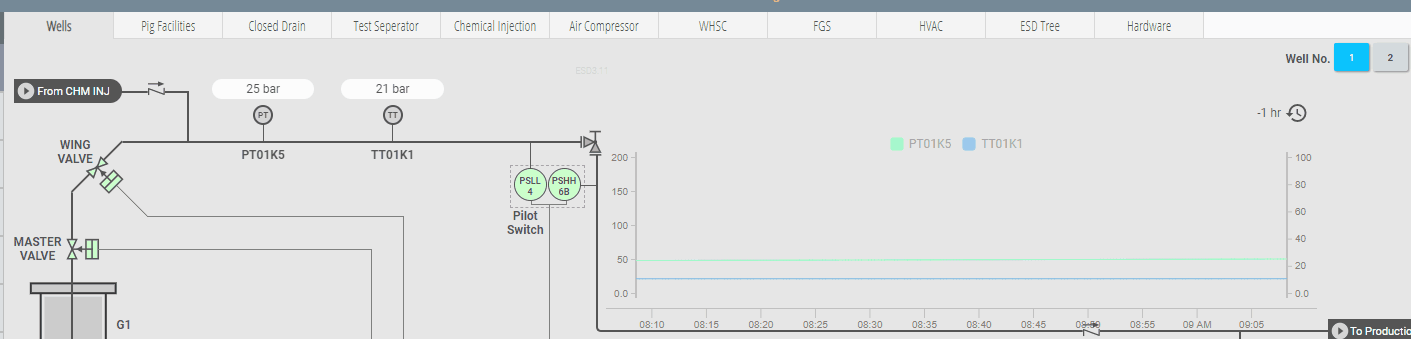

Hi,
When I set True the legend.visible property of the TimeSeriesChart, each time when I open parent view, the chart randomly doesn’t render correctly.
I found out zoom in/out browser trigger it and it render OK after re zooming the browser.
I test it in Chrome and ignition v8.0.6 to v8.0.10 and see same behaviour.

@nader.chinichian, can you post a screenshot of the rendering issue that you are seeing?
**Author:** ![nader.chinichian](https://sea1.discourse-cdn.com/inductiveautomation/user_avatar/forum.inductiveautomation.com/nader.chinichian/32/9261_2.png) [@nader.chinichian](https://forum.inductiveautomation.com/u/nader.chinichian)\
**Post date:** [March 25, 2020, 4:42am UTC](https://forum.inductiveautomation.com/t/enabling-legend-in-timeserieschart-cause-component-doesnt-render-correctly/33299/3 "2020-03-25T04:42:22Z")
Hi Joshua
The issue is that chart completely doesn’t show up. When I zoom in and take closer look it seems that the whole chart object offset from bottom to up and get out of the box area. It like I set bottom padding to component and make it get out of the box area.
 ![timeserieschart](https://us1.discourse-cdn.com/inductiveautomation/original/2X/a/a57adb0b75ba104f72d326c2014875652b2277d6.gif)
It is not seen in the gif but some times i can reproduce specially in different version from v8.0.6 to v8.0.10.
