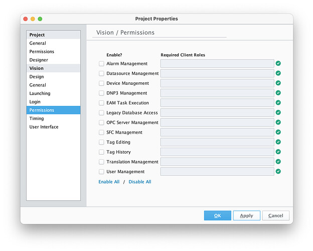

v8.1.19
Script works in designer but not in Vision client. Is this a demo mode issue? Gateway log follows:

**Post date:** [November 30, 2022, 5:01pm UTC](https://forum.inductiveautomation.com/t/error-500-error-executing-function-opcsystem-writevalues-the-current-user-does-not-have-the-required-roles-for-this-operation/67095/2 "2022-11-30T17:01:19Z")
> [@Eric\_G](#):
> `Caused by: com.inductiveautomation.ignition.gateway.servlets.gateway.functions.GatewayFunctionException: The current user does not have the required roles for this operation.`
Pretty self explanatory.
**Author:** ![Eric\_G](https://avatars.discourse-cdn.com/v4/letter/e/258eb7/32.png) [@Eric\_G](https://forum.inductiveautomation.com/u/Eric_G)\
**Post date:** [November 30, 2022, 5:02pm UTC](https://forum.inductiveautomation.com/t/error-500-error-executing-function-opcsystem-writevalues-the-current-user-does-not-have-the-required-roles-for-this-operation/67095/3 "2022-11-30T17:02:38Z")
There's only one user defined, admin. What are the required roles?
**Post date:** [November 30, 2022, 5:12pm UTC](https://forum.inductiveautomation.com/t/error-500-error-executing-function-opcsystem-writevalues-the-current-user-does-not-have-the-required-roles-for-this-operation/67095/4 "2022-11-30T17:12:18Z")
Check the Project Properties:
 ![image](https://us1.discourse-cdn.com/inductiveautomation/original/3X/6/2/622e7e628013646f70b05ffe123facd3689699fb.jpeg)
"OPC Server Management" (silly misleading name...)
**Post date:** [November 30, 2022, 5:15pm UTC](https://forum.inductiveautomation.com/t/error-500-error-executing-function-opcsystem-writevalues-the-current-user-does-not-have-the-required-roles-for-this-operation/67095/5 "2022-11-30T17:15:03Z")
Fantastic, checking that box and adding "Administrator" was the ticket. Thank you.
