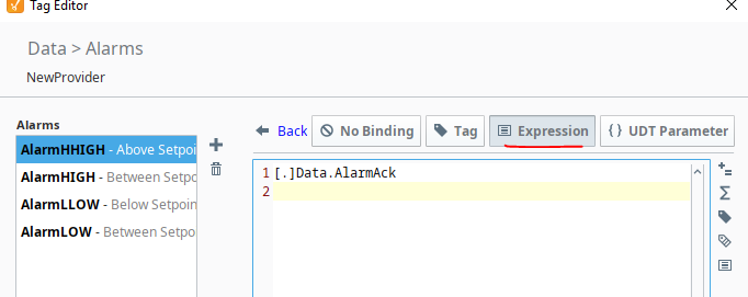

Secondly, I looked at the tag export you sent, and I’m seeing several instances of this:
 ![image](https://us1.discourse-cdn.com/inductiveautomation/original/2X/f/f88fe5df31ba5a39552c15f95d1b286454bb0844.png)
`[.]Data.AlarmAck` is not a valid expression. Strings either need quotation marks wrapped around the entry (making it a string literal, which you DON’T want in this case), or curly brackets (making it a reference/binding to something else, which you DO want).
The expression on the Active Delay and Ack Mode alarm properties should be `{[.]Data.AlarmDelay}` and `{[.]Data.AlarmAck`, respectively

**Post date:** [September 12, 2019, 5:58pm UTC](https://forum.inductiveautomation.com/t/error-alarm-tags-error/27805/5 "2019-09-12T17:58:43Z")
It works, thank you very much!
