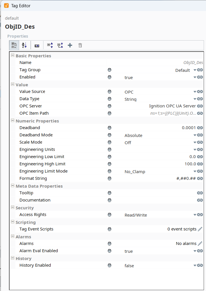

Hi everyone,
I'm encountering an issue in Ignition SCADA when writing an empty string ("") to a tag. After running my script, the tag value updates to an empty string as expected, but I still get a "Bad\_Failure" error popup. Here are the details:
Error writing "" to tag [Default]TestCompany/ML/A3/ObjID\_Des Bad\_Failure
- Tag Path: [Default]TestCompany/ML/A3/ObjID\_Des
- Error Message: Error writing "" to tag [Default]TestCompany/ML/A3/ObjID\_Des Bad\_Failure
- Script Behavior: My script sets ObjID\_Des to "". The tag value updates correctly, but the error persists.
- Tag Configuration:
-- Access Rights: Read\_Write
-- Tag Quality: Good
-- Data Type: String
-- OPC PLC Settings: Confirmed that the PLC allows writing empty string values
-- Security: Configured to allow Read\_Write for anyone
What I've Tried:
Verified that the tag is writable and has no security restrictions.
Checked the OPC server connection, which is stable.
Confirmed the PLC accepts empty strings for this tag.
Questions:
- Why does writing an empty string trigger a Bad\_Failure error even though the tag updates correctly?
- Is there a specific configuration in Ignition or the OPC server I should check to allow empty string writes without errors?
- Could this be related to the tag's OPC item settings or a bug in Ignition?
Thanks in advance!
**Post date:** [July 5, 2025, 12:39pm UTC](https://forum.inductiveautomation.com/t/error-bad-failure-when-writing-empty-string-to-tag-in-ignition/108154/2 "2025-07-05T12:39:59Z")
Is this a third party OPC server or Ignition OPC UA + driver? If Ignition, which driver? What’s the OPC Item Path of the tag?
**Post date:** [July 5, 2025, 2:14pm UTC](https://forum.inductiveautomation.com/t/error-bad-failure-when-writing-empty-string-to-tag-in-ignition/108154/3 "2025-07-05T14:14:47Z")
What if you write an ASCII 0x00, does it error?
**Author:** ![WRM](https://avatars.discourse-cdn.com/v4/letter/w/f475e1/32.png) [@WRM](https://forum.inductiveautomation.com/u/WRM)\
**Post date:** [July 7, 2025, 6:23am UTC](https://forum.inductiveautomation.com/t/error-bad-failure-when-writing-empty-string-to-tag-in-ignition/108154/4 "2025-07-07T06:23:07Z")
Sorry for getting back to you late! Here’s the image with the tag properties. I’m still figuring this out, so if you have any questions, just let me know!
 ![image](https://us1.discourse-cdn.com/inductiveautomation/original/3X/f/2/f2810db8a0a6dd6ff224d5046203d2acd59973f4.png)
 ![image](https://us1.discourse-cdn.com/inductiveautomation/original/3X/e/9/e9d4237257901faf5cdb6264ba844d055f7f2df2.png)
**Post date:** [July 7, 2025, 12:15pm UTC](https://forum.inductiveautomation.com/t/error-bad-failure-when-writing-empty-string-to-tag-in-ignition/108154/5 "2025-07-07T12:15:23Z")
Set the logging level for the `com.inductiveautomation.ignition.gateway.opcua.client.connection.OpcUaConnection` logger(s) to DEBUG and then try the write again. Afterwards see if there is an error in the gateway logs.
