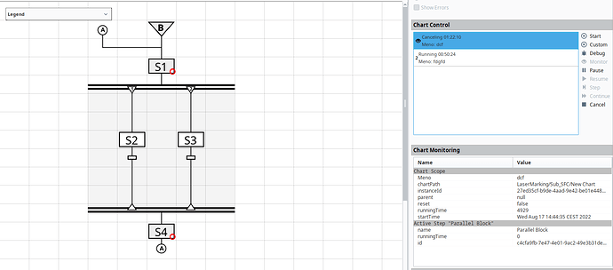

hi,
I have simple sfc without END. When a cancel condition of paralel seciton is true the sfc start from begining. **But when it reach the paralel section again it stuck (no steps are active)** even if the cancel condition wasnt true .
If I cancel whole SFC manualy it infinite stay in canceling status. Restart of SFC module helps to rid of the canceling SFCs.
any help pls?

Can you share the SFC with us?

There is no solution acording the Ignition support. I have to wait for potencial fix in future ignition update.
