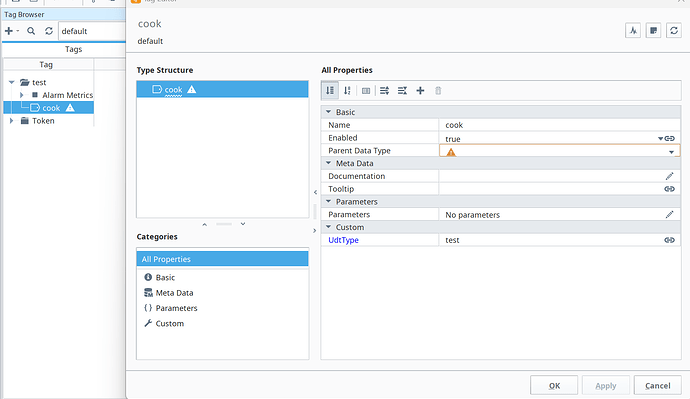

I am trying to create a UDT tag dynamically inside one of the existing tags, but it is not working.
 ![image](https://us1.discourse-cdn.com/inductiveautomation/original/3X/e/8/e8537fabfb440814e241044c08428608343ba3a5.png)
tagPath="[default]test"
#name="cook"
```python
# 1) Create the UDT instance from the DEFINITION, not the internal _types_ path
system.tag.configure(tagPath, [{
    "name": "cook",
    "type": "UDT_INST",
    "udtTypeId": "test", # <= use the UDT definition path
    "enabled": True
}], "o")
It is not working; it creates the UDT but does not create the child tags inside.
 ![image](https://us1.discourse-cdn.com/inductiveautomation/original/3X/6/1/61e63707e8a2725f6e2ed95cd518acd549f4d0a4.png)
**Post date:** [November 22, 2025, 2:27pm UTC](https://forum.inductiveautomation.com/t/error-creating-dynamic-tags/112375/2 "2025-11-22T14:27:05Z")
You cannot. UDT structures are fixed.
If you need variant structures, you typically need to use a regular tag folder. (Though you might make multiple UDTs from a base UDT.)

I know UDT structures are fixed. I am trying to get a UDT into a normal tag
**Post date:** [November 22, 2025, 2:52pm UTC](https://forum.inductiveautomation.com/t/error-creating-dynamic-tags/112375/4 "2025-11-22T14:52:54Z")
Ok. Might be a bug. I don't recall seeing anything like this, so you probably want to open a support ticket.

I don’t know where you got these from, but I suggest you create a UDT instance manually and check its json. The type should be `"tagType": "UdtInstance"` and use `"typeId”: ”test” `
On second thoughts, I'll bet this came from AI
Your original code is just creating a memory tag with those two added custom props in it
#name="cook"
# 1) Create the UDT instance from the DEFINITION, not the internal \_types\_ path
"name": "cook",
"tagType": "UdtInstance",
"UdtType": "test", # \<= use the UDT definition path
"enabled": True
}], "o")
I am getting parent data type doesn’t exists
 ![image](https://us1.discourse-cdn.com/inductiveautomation/original/3X/8/a/8abd6d702b6bacea4fc077a076adede7ffc07a10.png)

You ignored this part, and for some reason you renamed
> [@deepti\_k](#):
> `udtTypeId`
To
> [@deepti\_k](#):
> UdtType
When I said
> [@nminchin](#):
> use `"typeId”: ”test”`

yes it’s working..Thank you

That's a typical LLM mistake.
