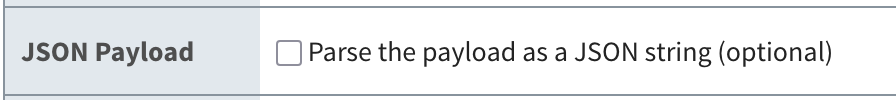

The error you were getting in the original post was this:
`Error processing edit for tag path '[MQTT Engine]teletest/application/26cff63b-1b2c-429b-8210-fc3985035143/device/74fe48ffff8b3d45/event/up/vib_sensor_01_tag/object/payload/Accelerometer/Z-Axis/Deviation': Bad_Unsupported("The target path '[MQTT Engine]teletest/application/26cff63b-1b2c-429b-8210-fc3985035143/device/74fe48ffff8b3d45/event/up/vib_sensor_01_tag/object/payload/Accelerometer/Z-Axis' cannot accept children tags.")`
When using a custom namespace, this typically indicates the structure is changing in such a way that what was originally created as a leaf tag is now expected to be a folder. If this can not be adjusted via the publisher, a custom parser is typically required. You can uncheck this option in the custom namespace:
 ![image](https://us1.discourse-cdn.com/inductiveautomation/original/3X/2/c/2c3ed24d791dd13a72b5aa16f14a0dc0a08391fa.png)
This means the json payload will now arrive in a single String tag. You can then create a tag change script to deal with the payload as you need and make sure to account for the changing structure.
