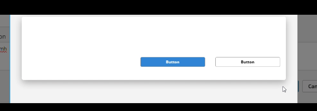

Hi, I have created a script in the project library for dynamic popup to which I send parameters such that my popup view is rendered according to the parameters on clicking a button. But the problem is, there seems to be glitch every time the popup is supposed to appear, it seems the glitch lasts only for a second but it is the skeleton view of the popup without the editing parameters. Does anyone know how this can be solved?

**Author:** ![Ryan\_Deardorff](https://sea1.discourse-cdn.com/inductiveautomation/user_avatar/forum.inductiveautomation.com/ryan_deardorff/32/63815_2.png) [@Ryan\_Deardorff](https://forum.inductiveautomation.com/u/Ryan_Deardorff)\
**Post date:** [September 5, 2025, 2:15pm UTC](https://forum.inductiveautomation.com/t/error-when-dynamic-popup-loads/110405/11 "2025-09-05T14:15:44Z")
> [@Thanya\_Gangesh](#):
I assume you mean this:
 ![image](https://us1.discourse-cdn.com/inductiveautomation/original/3X/2/c/2c6a6c721e20023b57e3fe270d307fdaabcd2301.png)
You should familiarize yourself with the `persistent` property of bindings. I’m guessing the button text is bound to a parameter, but the default text of “Button” will show for a split second before the binding is resolved from an initial null value. You can provide an alternate default value for an initial null value by using the `coalesce` function in a binding expression:
```python
coalesce({view.params.buttonText}, '')
That should make the button appear blank before the parameter text shows up, assuming the text property is not set to `persistent` (the default for bound values).
Alternatively, you could check the `persistent` property of the text, in which case whatever value is present when you save the view is what will initially appear.
