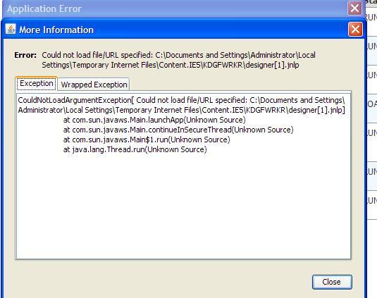

Hi,
When i click on launch designer button it give me error “could not load file url specidified”
**Author:** ![talhajee](https://avatars.discourse-cdn.com/v4/letter/t/b3f665/32.png) [@talhajee](https://forum.inductiveautomation.com/u/talhajee)\
**Post date:** [March 1, 2010, 8:47am UTC](https://forum.inductiveautomation.com/t/error-when-i-click-on-launch-designer/1592/2 "2010-03-01T08:47:00Z")
Attached is the snapshot
 ![](https://us1.discourse-cdn.com/inductiveautomation/original/1X/cb371a9b5197e60e8143fa9742cf7bd48d6a82be.JPG)
**Author:** ![AlThePal](https://sea1.discourse-cdn.com/inductiveautomation/user_avatar/forum.inductiveautomation.com/althepal/32/3603_2.png) [@AlThePal](https://forum.inductiveautomation.com/u/AlThePal)\
**Post date:** [March 1, 2010, 12:09pm UTC](https://forum.inductiveautomation.com/t/error-when-i-click-on-launch-designer/1592/3 "2010-03-01T12:09:33Z")
Try clearing your Java cache and trying again - this will download a new version of the Designer.
**Author:** ![Carl.Gould](https://sea1.discourse-cdn.com/inductiveautomation/user_avatar/forum.inductiveautomation.com/carl.gould/32/7262_2.png) [@Carl.Gould](https://forum.inductiveautomation.com/u/Carl.Gould)\
**Post date:** [March 1, 2010, 5:46pm UTC](https://forum.inductiveautomation.com/t/error-when-i-click-on-launch-designer/1592/4 "2010-03-01T17:46:21Z")
Al’s suggestion is the right place to start. Also clear your IE6 cache.
We are seeing a few reports of this error coming in, it seems to be a problem isolated to IE6’s faulty caching mechanism, where it removes the JNLP from the cache before invoking javaws.exe for some reason we haven’t identified yet.
