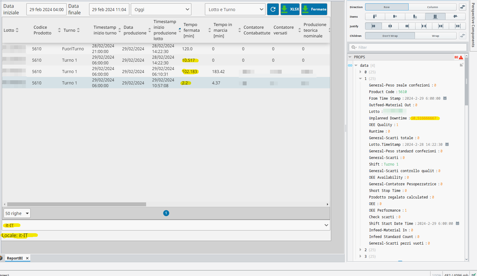

Hello,
I'm on ignition 8.1.31.
I have a table with float numbers that have to follow the locale format.
Example:
en-US -\> 1,000.5
it-IT -\> 1.000,5
At this moment even if I change the locale in the perspective session properties it always shows the en-US format.
What should I do to avoid this behavior?
I need to see the italian format if the project or the session locale is it-IT.
 ![issue format number](https://us1.discourse-cdn.com/inductiveautomation/original/3X/1/8/181c7a3d91a526c254bea25f38fc200b00b8c35d.png)
Thank you,
Flavia Delli

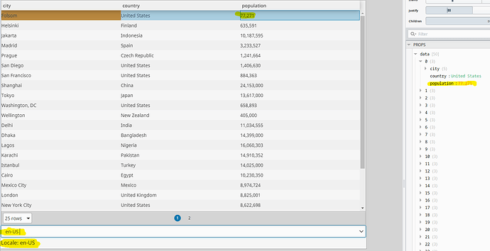

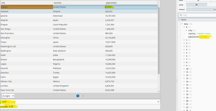

![table locale it](https://us1.discourse-cdn.com/inductiveautomation/original/3X/a/e/ae61e4a983e6477f5c9759c784aa6da0887695a5.png)
 ![table locale](https://us1.discourse-cdn.com/inductiveautomation/original/3X/7/d/7d7a0453e7feb2e2a1b21c70589f4fe9e33609dd.png)
The screenshots show the original dataset used in the component table, I just dragged and dropped it in to the view .
As you can see there's the very same behavior.
On the property the data is shown with the it-IT locale, but in the view is always en-US even changing the Locale.
(I also tried launching the perspective session and the result is the very same)
Does the windows gateway Region condition this functions?

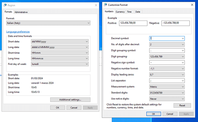

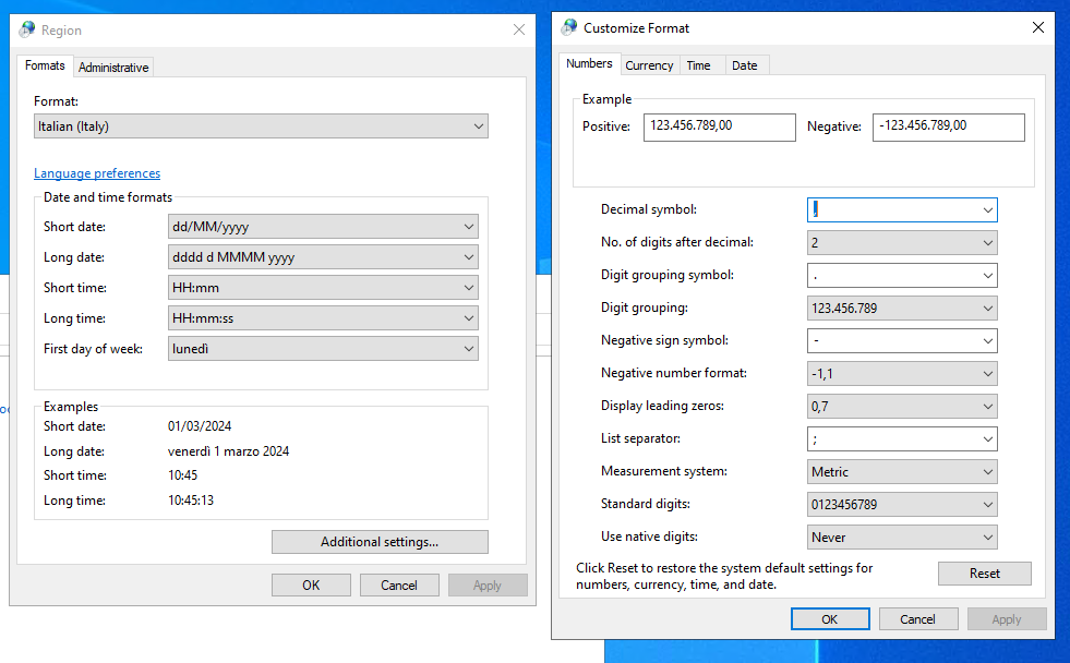

Here the region info:
 ![Region](https://us1.discourse-cdn.com/inductiveautomation/original/3X/0/c/0c677c2bba4df9043b1594ef996d9e0aaa55eaf9.png)
