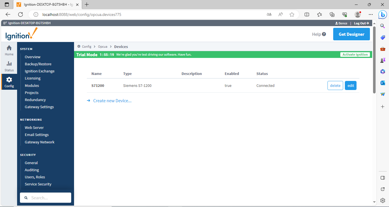

I connected my PLC (s7-1200) in the gateway ( it works good):
 ![gatewy](https://us1.discourse-cdn.com/inductiveautomation/original/3X/3/4/3484c0a745fbdace5f864d640213a25ddcab6be5.png)

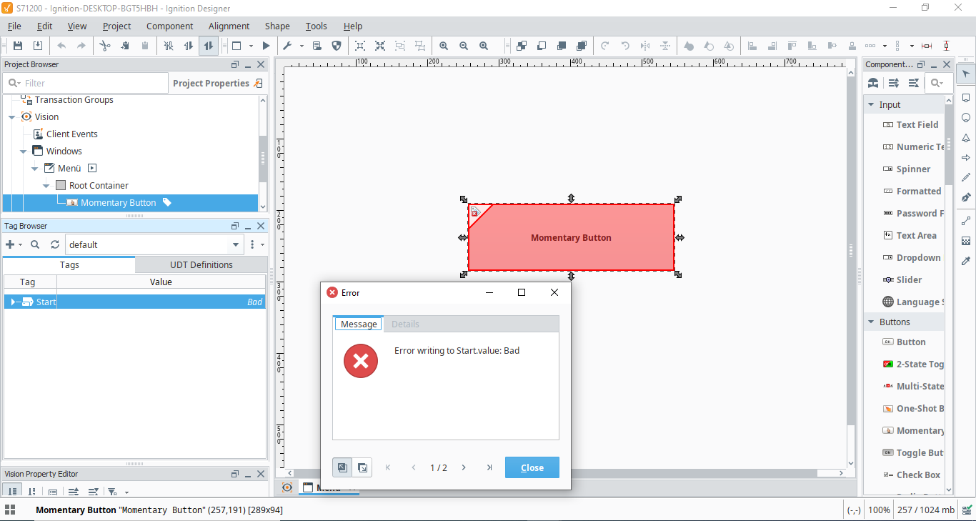

But I don't write this tag in the designer and here is the error screen:
 ![launcher](https://us1.discourse-cdn.com/inductiveautomation/original/3X/e/c/ec63d200d1b01aa6a2cdd257e2c7a1c9bce28105.png)

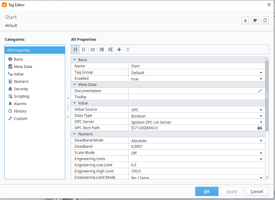

The tag is just a simple tag:
 ![input](https://us1.discourse-cdn.com/inductiveautomation/original/3X/b/f/bf3f238251891a9572d10aff8fa788f2bd884ced.png)
Do you have idea what is the problem? Why show the error screen and the error code? And why I can't write this tag?
Error: Error writing to Start.value: Bad
Thank yo for helping!

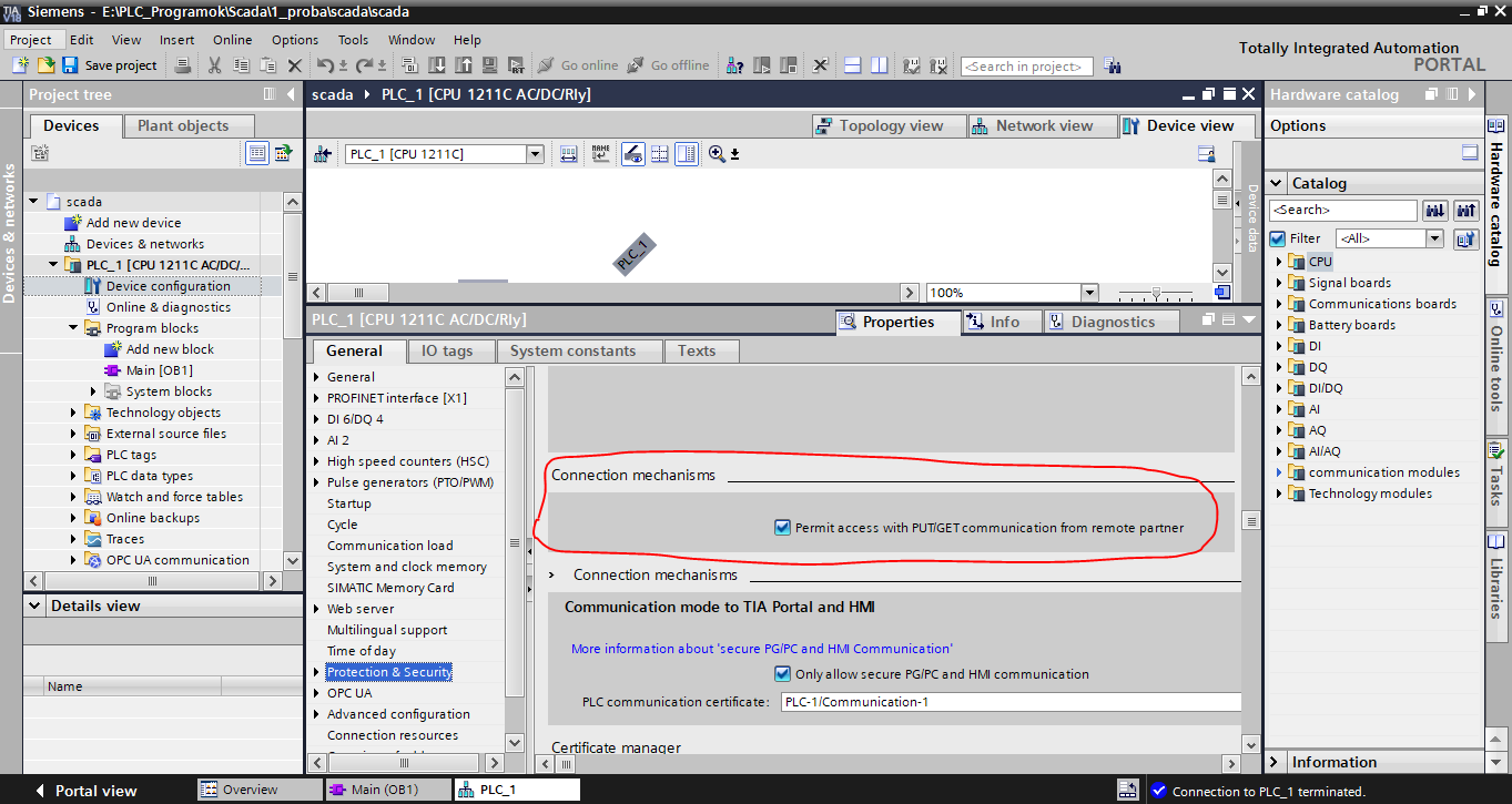

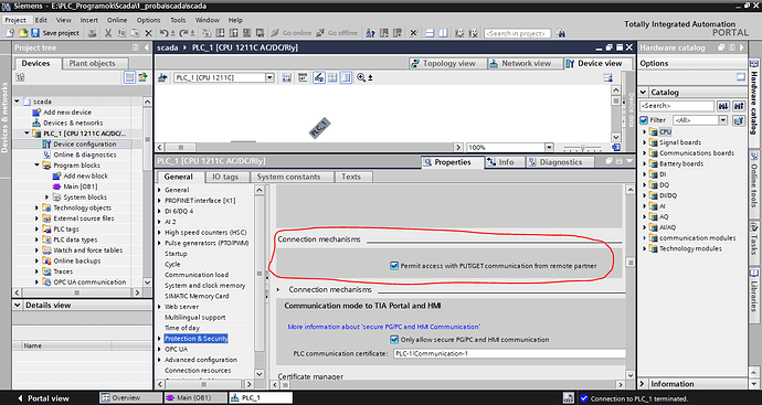

I find the solution and I show this.
If you use TIA portal you have to put on this box. For me that was the solution.
 ![problemgood](https://us1.discourse-cdn.com/inductiveautomation/original/3X/a/4/a4d8edeca472f1d13c92ba5692af0e7d09154675.png)
**Post date:** [February 7, 2024, 1:24pm UTC](https://forum.inductiveautomation.com/t/error-writing-tag-value-bad/85284/3 "2024-02-07T13:24:49Z")
It always helps to read the documentation for the driver you are trying to use:
[https://docs.inductiveautomation.com/display/DOC81/Siemens#Siemens-Considerationsfor1200and1500Devices](https://docs.inductiveautomation.com/display/DOC81/Siemens#Siemens-Considerationsfor1200and1500Devices)
