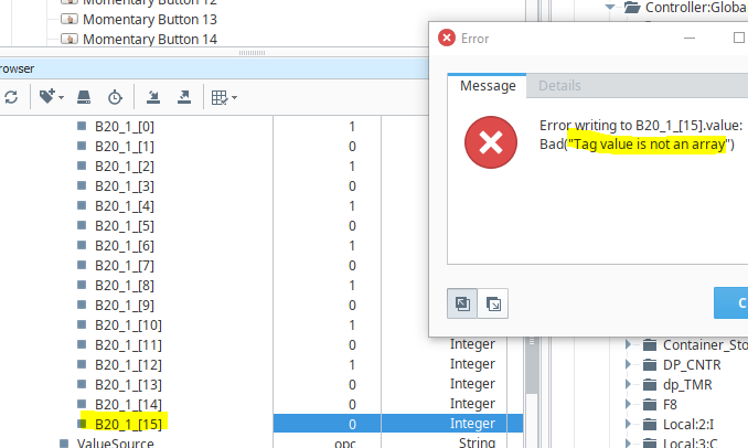

Hello guys,
Quite new to ignition. I ran into an issue where i cannot write to an Integer array. Could someone lend me a hand.
Thx!
 ![image](https://us1.discourse-cdn.com/inductiveautomation/original/3X/8/c/8c33dbe903a8963b10d8522aaef148ac9aa08a05.png)
 ![image](https://us1.discourse-cdn.com/inductiveautomation/original/3X/f/1/f10003f023ea21a1c129e7d0c8c092fd3e80b78d.png)

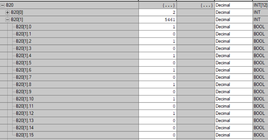

SOLUTION!
 ![image](https://us1.discourse-cdn.com/inductiveautomation/original/3X/5/8/586ddd45734338fd18e760129a407b511cba84d5.png)
> [@Tag Array support, problem with the write](http://forum.inductiveautomation.com/t/tag-array-support-problem-with-the-write/11193/6):
> Here is what I have found: Brought into the tag browser as an array I cannot write to or address individual bits. All I can do is read them. Correct? If I create a normal integer tag and append the path name with a “.(bit address)” then I am able to read and write to that specific address. Is this the best way to address or specify individual bits within an Allen Bradley DINT tag?
