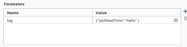

I have this parameter on a view I want to open in a pop-up ![image](https://us1.discourse-cdn.com/inductiveautomation/original/3X/e/b/eb13fb5f69de052f8642d1c9a48225a704eeaeed.png)
I can’t figure out the syntax in the event configuration section. I figured it would be something like this:
 ![image](https://us1.discourse-cdn.com/inductiveautomation/original/3X/9/e/9e3b478aedebfa90e5979c4a31528823696f8764.png)
But that gives me a null value. Is this possible?

try having `tag.lastReadTime` as the name and just passing `hello` as the value. I know that you can read from objects in a similar fashion so maybe it will work this way as well

Thanks for the suggestion. Unfortunately, it didn’t work. When I try that, I do not get a null value. Instead, I get the default value for that parameter. In this case “test”.

Okay, so ignition is interpreting what you are passing it as a path to a property instead of treating it as a standalone object. If you notice if you select a path to a parameter, it shows as `{path.to.item.parameter}` in the value box
You can get around this by either by creating a custom property on the root container of whatever is calling the popup and then referencing that custom property in the event or you can utilize `system.perspective.openPopup` in scripting, which will allow you to pass pretty much anything to the popup parameter.

Thanks Ryan. The first suggestion still gave me the default value. I ended up using system.perpsective.openPopup as you suggested.
