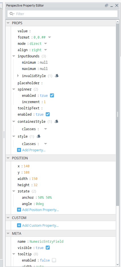

Hi, I’m using a Numeric Entry Field, and I want to update a tag value when the numeric value changes. However, I don’t see any `onValueChanged` or `onChange` event in the component’s event list.
Does anyone know how to handle value changes for this component?
Thanks.

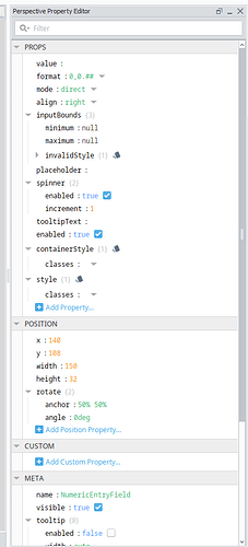

In Perspective, you attach change scripts to individual properties, not as component events.

What phil ment is that you should look at this section of the component instead of the configure events.

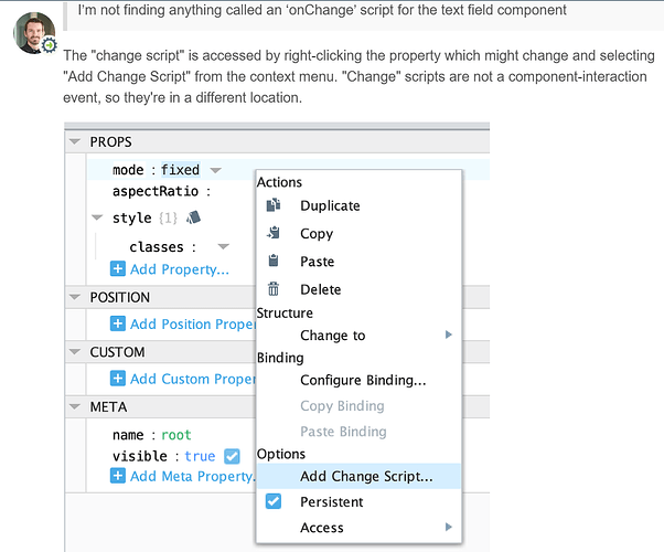

Thanks a lot @pturmel and @Cose_Peter1 .
I found some documentation that helped me understand what you were explaining.
> [@Perspective - Text Field onCompositionEnd](https://forum.inductiveautomation.com/t/perspective-text-field-oncompositionend/37448/10):
> The "change script" is accessed by right-clicking the property which might change and selecting "Add Change Script" from the context menu. "Change" scripts are not a component-interaction event, so they're in a different location. You're looking for onFocus.
