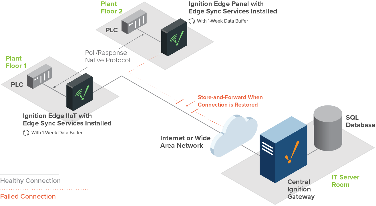

Hi,
do we get the data in event stream (with source: Tag Event) from edge data sync? In particular, in case there was a disconnect and the buffered data are synced evenuelly.
Bests,
André

Can you better explain the scenario / architecture where these two technologies work together?

Hi @Kevin.Herron
sure, I will try it.
If we have an architecture like this. Will those technologies, Edge Sync with S&F and Event Streams at the Central Ignition Gateway, work together?
**Concrete:**
1. Edge collects data from the PLC
2. Data sync to the central gateway [**Is this a source for the event stream?**]
3. Edge and central are disconnected
4. Edge buffers the data
5. Connection is restored
6. Edge syncs the buffered data to the central gateway [**Is this a source for the event stream?**]
 ![image](https://us1.discourse-cdn.com/inductiveautomation/original/3X/0/d/0d5f010685930d5e81e35c11400fbef370d681ca.png)
**Post date:** [July 30, 2025, 11:40am UTC](https://forum.inductiveautomation.com/t/event-stream-and-edge-sync/109129/4 "2025-07-30T11:40:13Z")
> [@Andre\_Hennecke](#):
I'll check with somebody to make sure, but I don't think these work together. Edge sync and S&F are for things backfilling history, they're not a real time tag value source.
